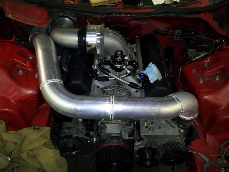

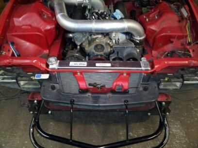

Wow! Old thread. Here's a couple picture updates of mine in progress, should be up and running this spring:
