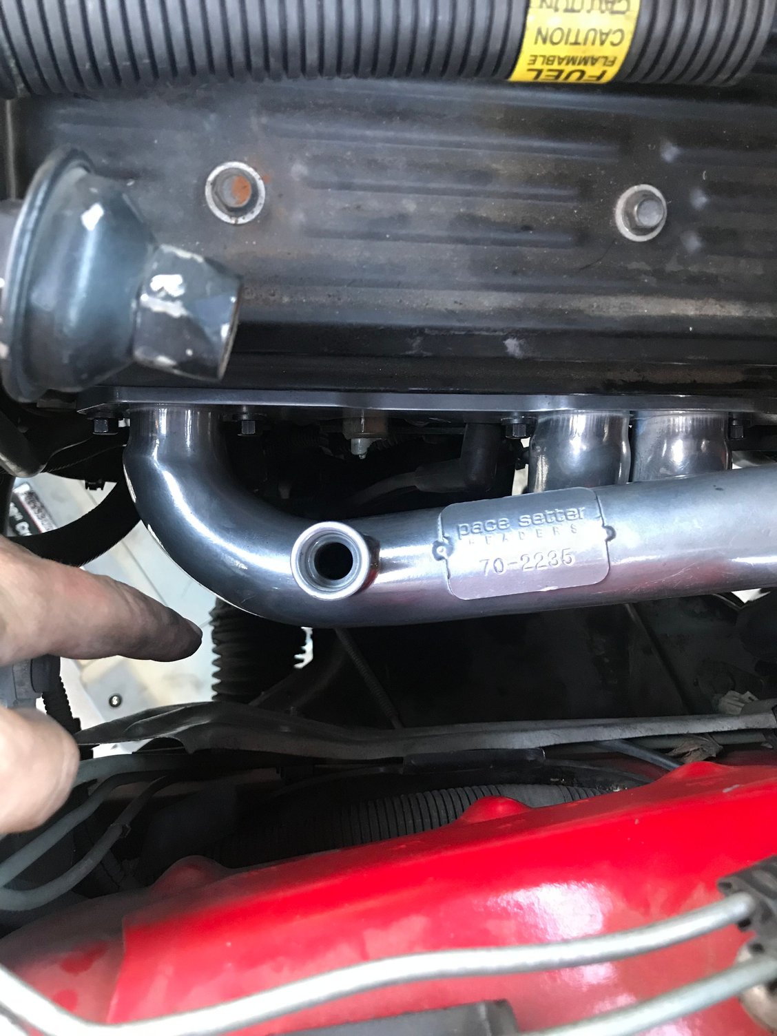

1995camz28's Avatar
Joined: Jan 2017
Posts: 32
Re: 1995 Camaro z28 smog
This is what I’m dealing with here. The egr tube won’t line up with the header flange and the auto transmission dipstick is in the way. I’ve tried bending it but I cannot get it to fit.

Old Jul 7, 2019 | 11:16 PM
95LT4Z28's Avatar
Joined: Jan 2016
Posts: 151
From: queens ny
i used Dorman Oil Pan Drain Plugs 65226 to plug the slp heahers on my 95. its a 3/4 16 thread. fit my perfectly
