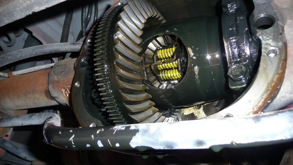

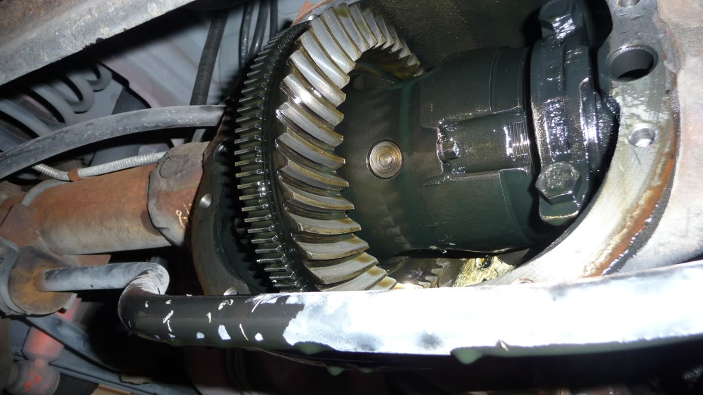

ok well i pulled the cover and didnt discover anything that would seem like a problem. Gears look fine, some metal shavings on the magnet on the cover and that was about it. I checked theoil the other day and it was full. When i pulled the cover off just didnt seem like there was as much oil as i thought there should be. How much should it have btw? Also any other suggestions?

nobody knows whats wrong even with the pics and video????
