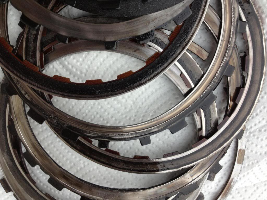

the 3rd gear clutches burned up and littered the whole transmission with fragments
