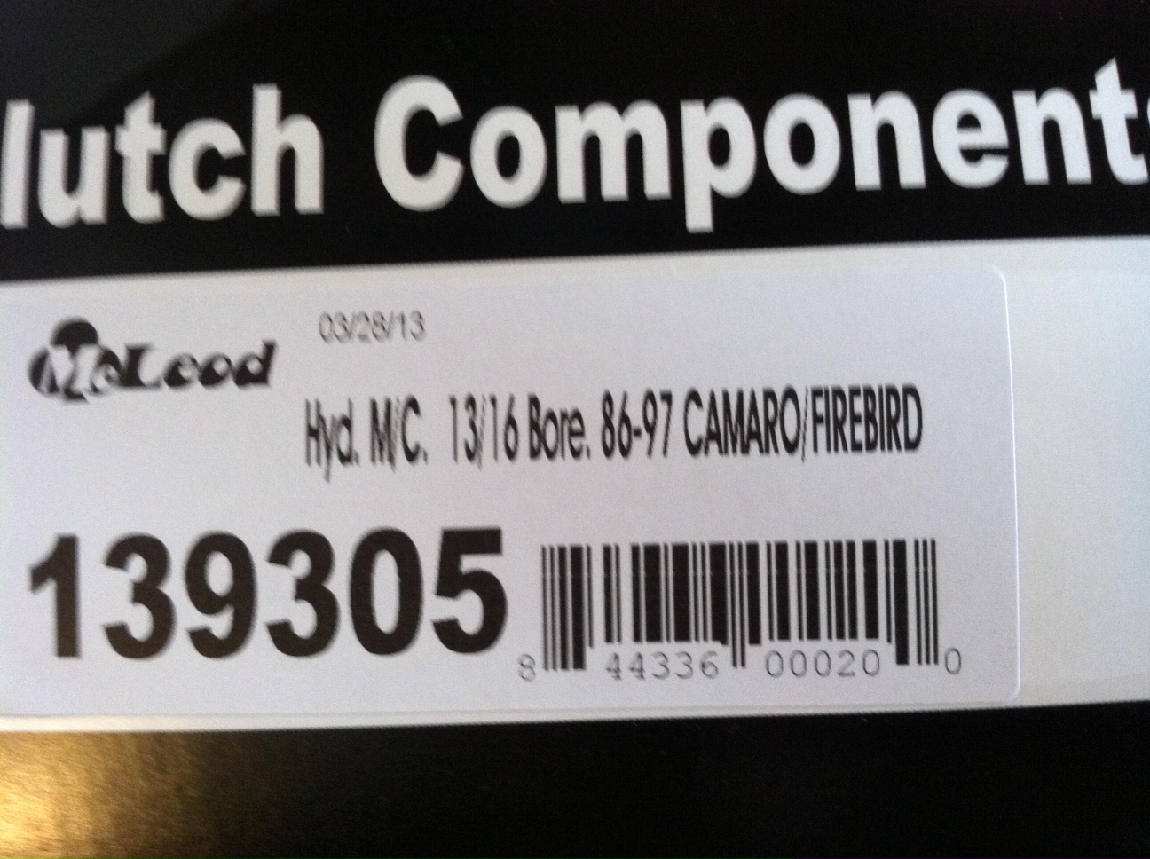

is it the Wilwood or Tilton MC?
Mine is the Wilwood. McLeod stopped using the Tiltons

The McLeod Street Twin needs the larger 13/16" bore MC for LT1 "pull" clutch

that is the Tilton. The problem with those were the hole inside the MC the rubber cup passes over was not smoothed out so it cut the rubber cup. This would make it not work well and leak. IIRC McLeod offered a rebuilt kit for them which was not cheap for a rebuild kit but I did read on another forum a guy who kept having the issue found a brake cyl rebuild kit at NAPA for a few $ that was the right size
IDK if this is your issue but I do know people who had the Tilton had issues with them not holding pressure, apparently because of torn piston cups inside
The Wilwood MC kit is sold by McLeod and is 13/16" bore. You need the 13/16" vs the stock 3/4" MC for the "pull" Mcleod Twin clutch

well since you have a McLeod Twin you need a 13/16" MC...buy the Wilwood from McLeod. Especially if the Tilton Hawks is selling is like the model you have...they are chronic problem.
Tick sells a MC using a "newer" Tilton MC but IDK if it is 3/4" stock bore or they offer it in a 13/16" version
You need either a larger MC or a smaller bore slave for the street twin in a LT1 car. There was a guy using a stock MC and smaller bore slave IIRC for a Jeep or something he got for $50. He did have to make his own slave adapter mounting plate for it though.
IMHO get the McLeod/Wilwood unit and stock slave.

Yes there has been a few "revisions" on the street twin over the years. I suspect the sleeve for the slave was meant to reduce its bore size effectively giving it more stroke with a stock 3/4" bore MC
Then they switched to the all metal MC which was a Tilton (like what the OP has). People reported having MC failure due to torn rubber piston cups because the cup moved over a hole in the MC which was not chamfered.
Now they offer a larger MC, 13/16", made by Wilwood and you use the stock slave
