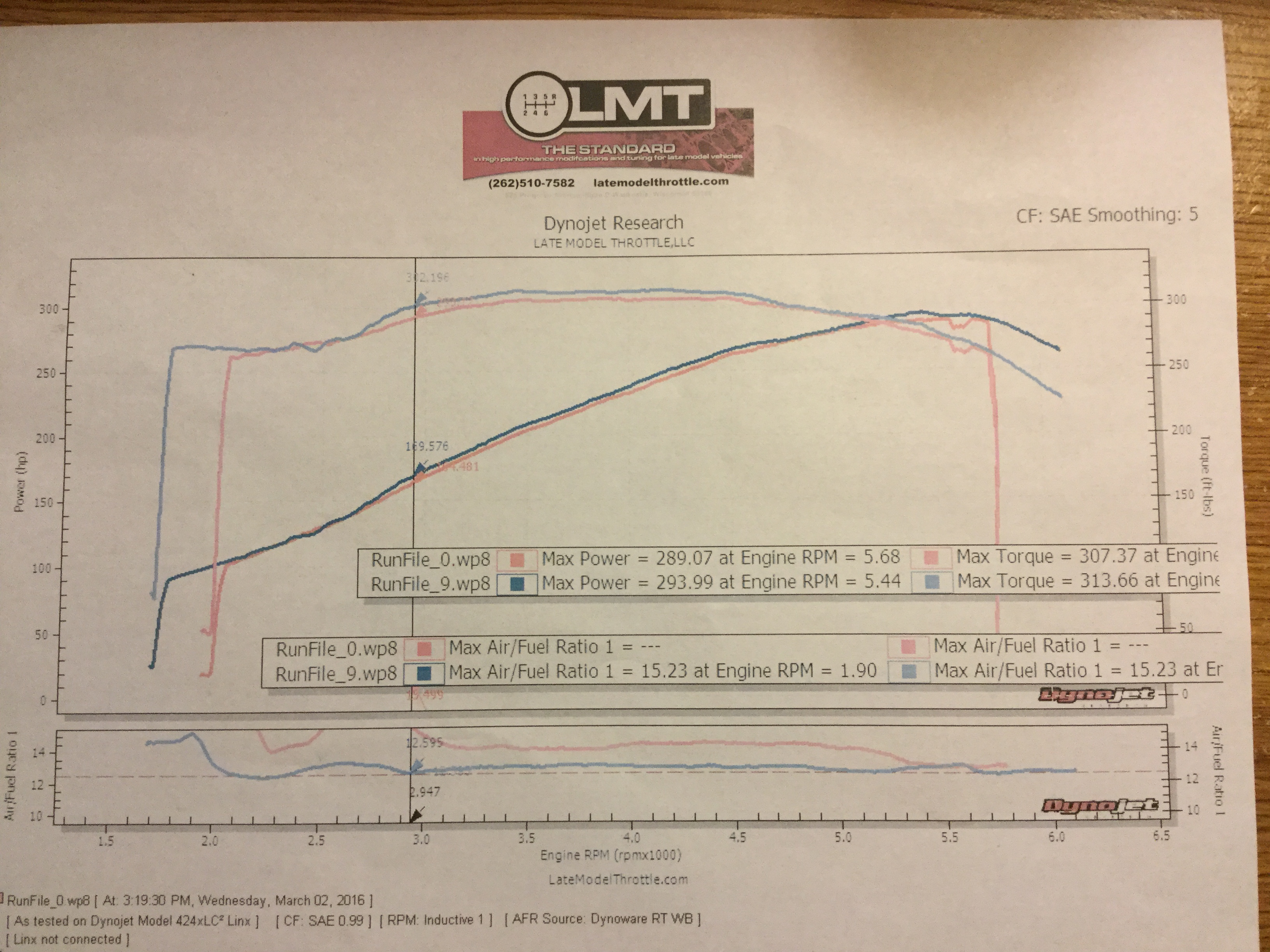

Here's the dyno graph with the AF ratio at the bottom. Tell me what you guys think could be a problem if there is one.

Almost looks like a curve for a stock LT1 with CAI and headers/catback.
If I'm interpreting the scale correctly on the A/F ratio, appears its a bit rich (12.5:1) at 5,000 RPM and above, except for the bump at 5.500 RPM. The bump to a leaner value in run 9 corresponds to only place where there was a moderate increase in HP vs run 0. He obviously had to lean it out fro run 0, but usually it will make best power closer to 12.8 - 13.2:1. However, that's not going to make up for the 30-40 HP it's missing.
Did he do the pull in 4th gear?

He did do the pull in 4th. I guess the only thing left to do is get another tune from another shop then? I mean besides the car being low on power, it still has a bit of a miss to it. Likely from the A/F ratio being off.

The curve clearly indicates it is corrected to SAE standards, eliminating the shop's atmospheric conditions and elevation. Fuel differences by region are not going to cause what appears to be at least a 10% shortfall. Sure, running it at 87 octane at sea level would be a valid concern. The use of the wideband, and the fact the PCM does not use the O2 sensors for PE mode eliminate bad O2 sensors.
Condition of the motor and parasitic drivetrain loss differing from normal are things the need to be investigated.
