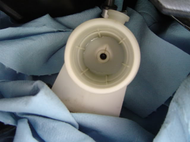

I emptied the reservoir and filled it with fresh fluid and proceeded to "mix" it with the old by depressing the clutch pedal 30 times as shown in the video in the link above. There was very little dirt in the fluid after the first time but just the same I repeated the procedure three more times. This did not fix the problem. I was trying to figure how to do a proper bleed and flush. My two shop manuals are of no use to me whatsoever since they don't tell you how to access the bleeder valve. I took this picture under the car where the hydraulic line goes into the bellhousing. I would assume the bleeder valve is in there somewhere but was wondering how one gets to it.

The only other problem I see developing is a hair line crack in the reservoir. There is no evidence of a fluid leak on the outside so for now I'll just keep an eye on it.

If it was the slave it would be leaking fluid into the bellhousing. I have talked to several mechanics who have seen this issue repeatedly and they all say the fluid is bypassing the plunger in the MC and returning the the resevoir. The reason that the pedal sticks down is that the mc rod has the fluid behiond it holding it down so it wont come bsck up till lifted forcing the fluid back into the res. If it was the sdlave leaking, the pedal would come back up, but it would drag air into the system as it did. I am totally totally certain that it is the MC
