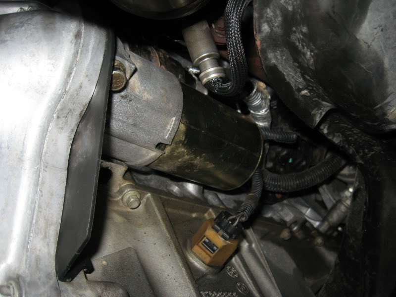

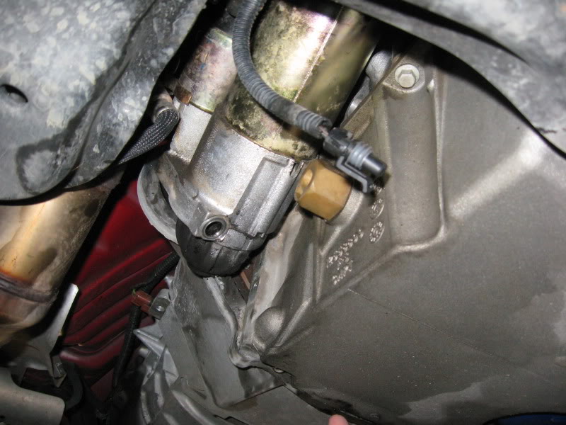

I saw that link too. Somebody told me about a drill mod that fixes a sticky clutch pedal issue on Camaros, but since I don't own a drill, I never read about it. If I remember the summary, it basically said that the hole for something or other wasn't big enough and if you drill it a little bigger, it fixes the problem.
You might check the underside of your car with a very bright light and see if you have clutch dust all over your starter. Your starter is located on the passenger side of the car on the side of the transmission very close to the catalytic converter if your car is an '02. You'd have to get your entire head under the car to see it, I don't think you could just look under your car and see it.
Here's a pic, keep me updated and what you find.
2 dirty pics, 1 cleaner pic after the guy changed the clutch
Is it just me or does the transmission look like it is mounted funny now?!?! Or is it mounted funny from him checking the clutch earlier...?!?!
