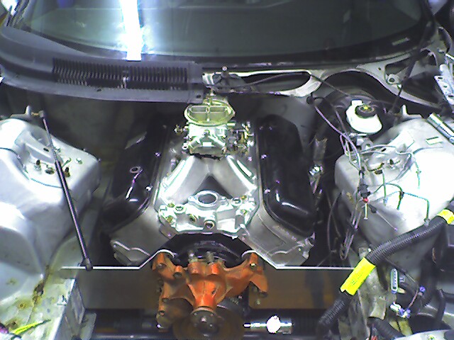

Update: The motor is sitting in the car right now. Not yet welded but it's sitting there. As people have said some serious trimming is in order when you do this transplant.We cut the cowl back but the carb is still touching a bit in the back so a slight bit more trimming is necessary. I am running a Holley Dominator intake so if you run a lower rise intake you'll have better clearance.
Also, contrary to other peoples experience, we have been able to retain the windshield wipers. I'm going to need a cowl hood for clearance with the carb. Also we ended up using the madman motor plates from Thunder Racing which we trimmed another half inch off for our own application. The BMR tranny crossmember worked great for the powerglide we just had to elongate one of the holes to fit it. Uses the same trans mount.
I've got some pictures I can post, but I usually do that on cardomain because I don't know how to post here. If anyone wants to post them I can e-mail them to you no problem. Just shoot me an email to pontiac510@gmail.com
I'd like for the other members to see them actually. So, can someone help me?

send me the pics, I can host them...
brady.mcnew@williams.com
I'll get them up tomorrow.

Sent the pics to Brady so they will be up when he gets a chance.

That looks great. Only thing I'm wondering about is the steering shaft with headers in there. Did you use the stock k-member?

It's the stock k-member. We moved the steering shaft about an inch to the drivers side to clear the headers and we cut off the old mounts where the rack used to sit. Well also have to notch the k-member in the back for the header to clear as well. It works but it might have been much simpler with a tubular k-frame.
Brady, thanks for hosting the pics for me.
