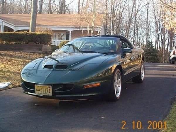

As noted above I ran 17 x 9.5” 49mm offset wheels on my 94. The 46mm offset would move the wheels less than 1/8” toward the outside of the fender - hardly noticeable. It is near the outer limit in the front, no problem in the back. There's a photo of the OZ 49mm wheels in the wheel and tire FAQ, here:
https://www.camaroz28.com/forums/whe...2/#post3422887
When I briefly had the car lowered, the fronts would rub on the plastic inner fender on a hard bump, particularly with the steering at full lock.
Here's a photo at stock height, from the front:
