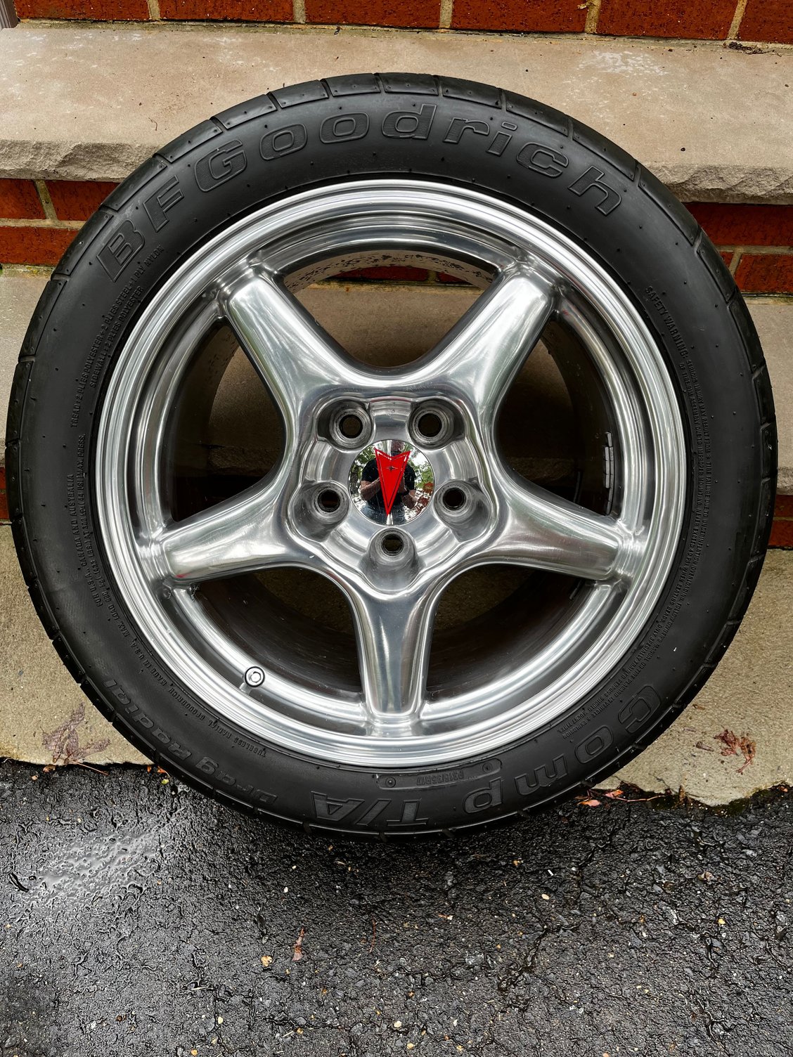

96, 97 SS ZR1 style wheels installed on SLP modified cars are 17x9 with +50 mm offset. Work best with 275/40 17 tires plus with a square setup you can rotate the wheel/tire assemblies for better tire wear.
Shod with BF Goodrich g-force Comp 2 tires 275/40 17, 3 years old. If you are driving distance to Knoxville TN, wheels, tires, lugs and center caps are for sale. 10k miles on tires. Wheels are polished aluminum.
