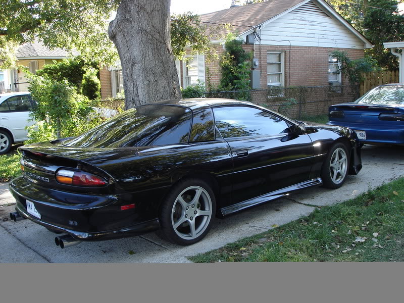

I went with C6 Z06 Replicas and I love them
y2k wheels. love them. 17x8.5 front, 18x9.5 rear
255/40/17 275/35/18 tires
