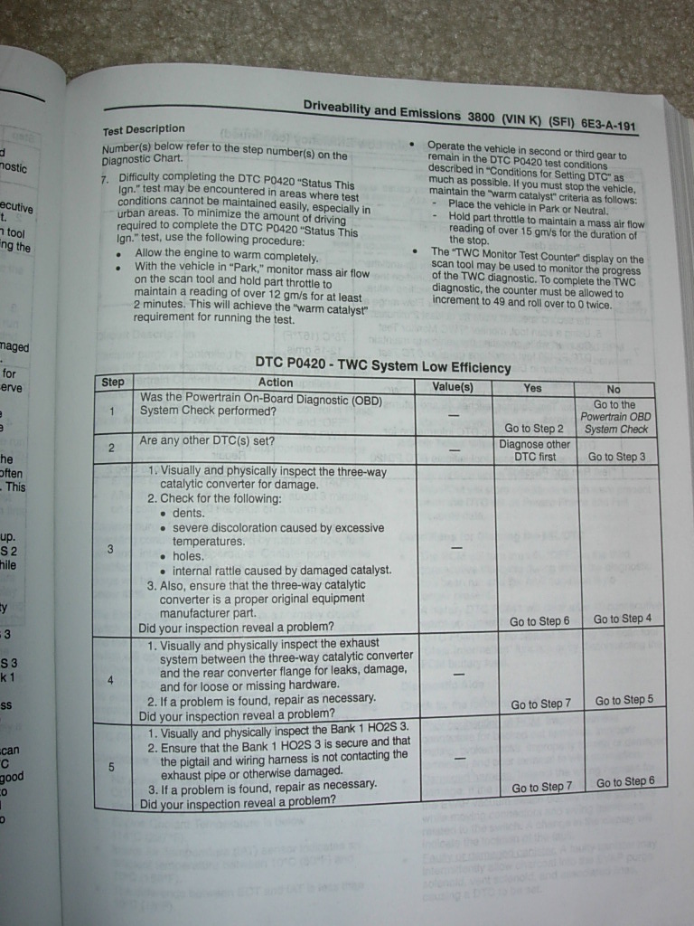

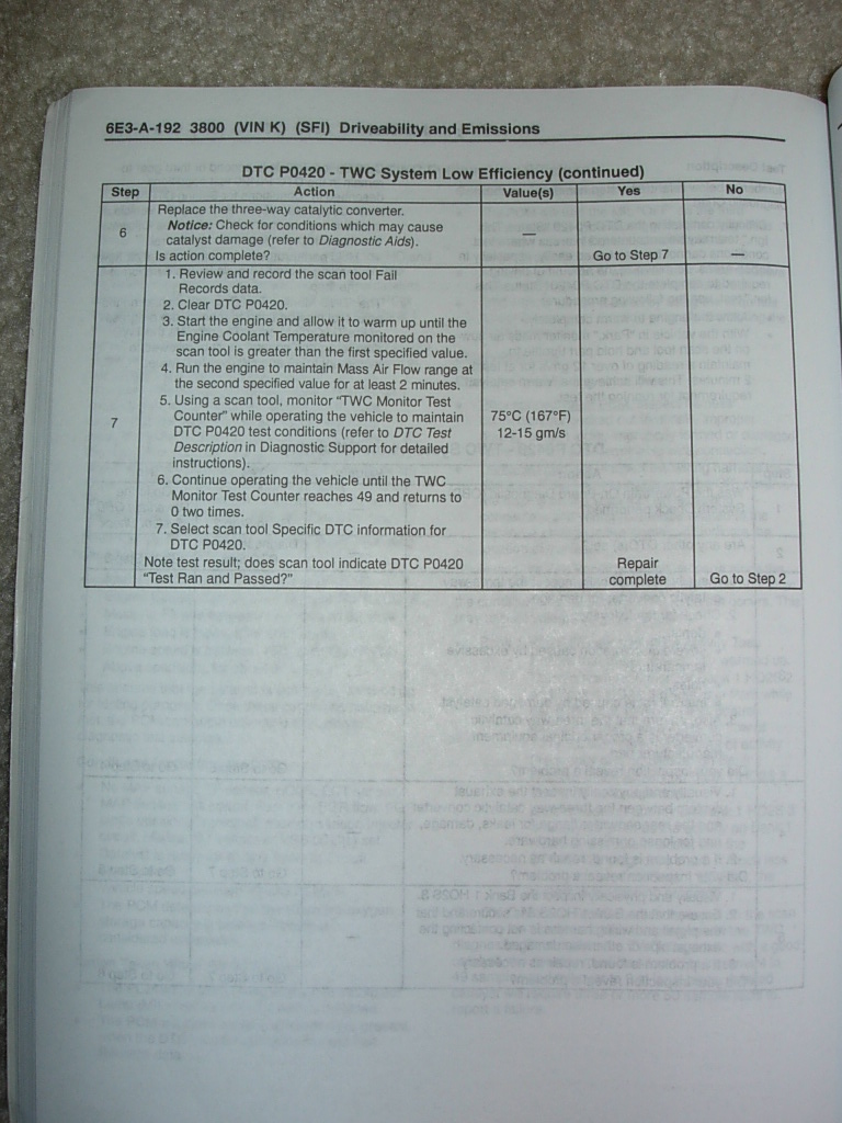

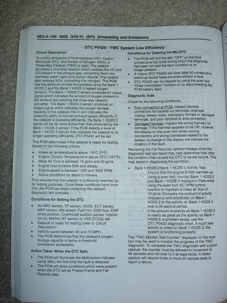

This is from my 1996 factory manual, but should apply to your V6 as well. Right click and view image to view at full size.

mine has been throwing the same code since last year when i put and aftermarket magnaflow exhaust with an aftermarket hiflo magnaflow cat on it. i dont know what to do to make it go away either...ive heard that an 02 simulator is needed. dunno where to get one, which one to get, and where to put it on the car...help please
Old Sep 27, 2008 | 01:00 PM
ACE1252's Avatar
Joined: Mar 1999
Posts: 2,068
From: Kernersville, NC
I think your problem has got to be the cat. Look above.....the manual states to make sure that the cat is OEM spec. Your highflow cat is not working to the PCM's satisfaction. I know for certain that a muffler will not hurt anything. I ran one on my 96 3.8 without issue(dynomax superturbo from RKsport).
