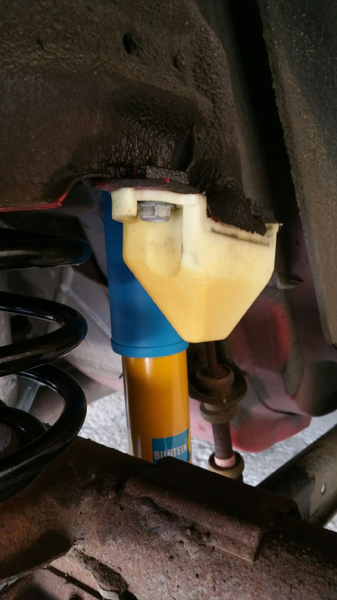

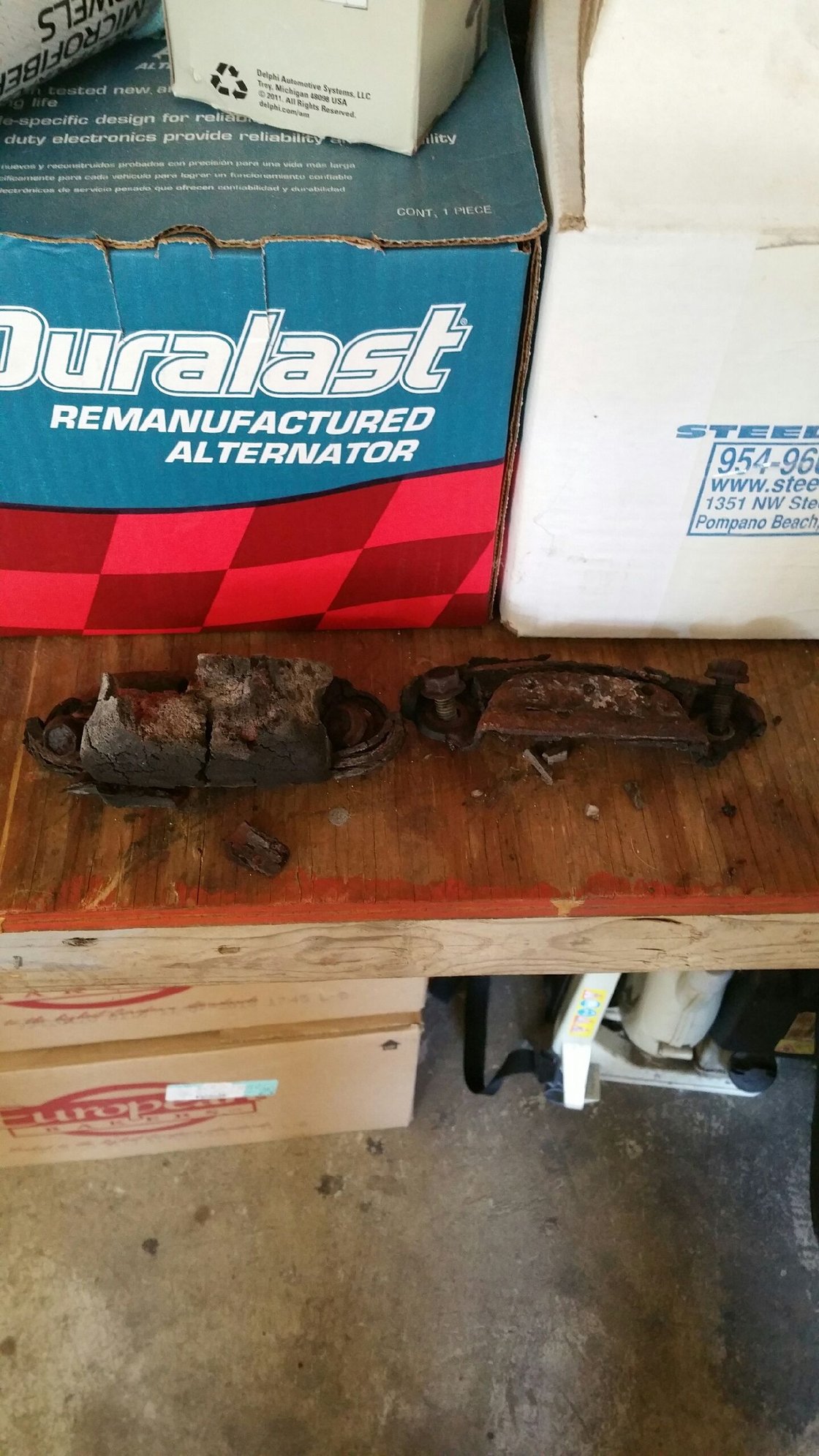

I was taking off my drag radials and noticed this

4gen disease, many also
Old Jun 18, 2020 | 12:11 PM
Posts: 71,098
Re: I think my bump stops are shot

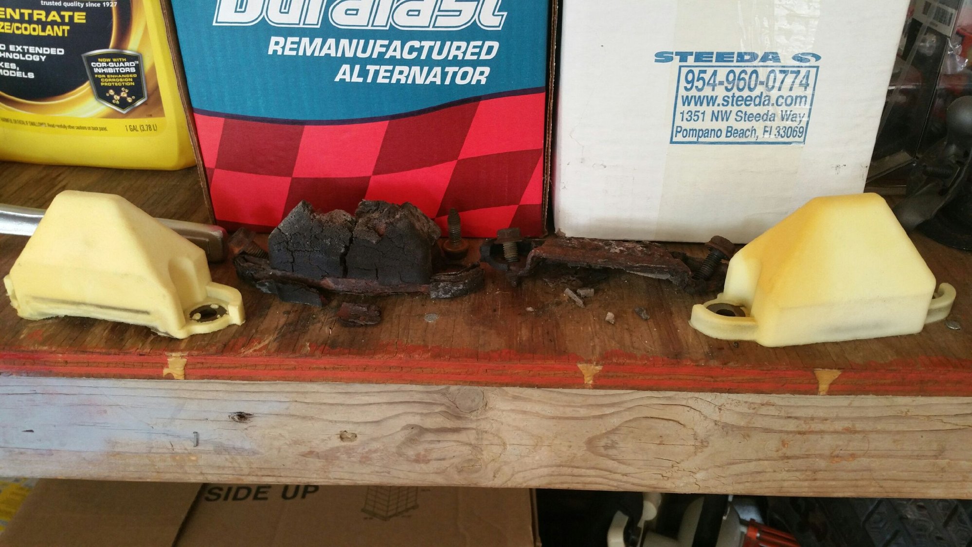

The stockers, at least the ones on my 94 appear to be some sort of rigid "foam". not a hard rubber. Not sure what they are made of, but is obviously doesn't last 20 years. I need to look at mine... haven't driven the car in years.

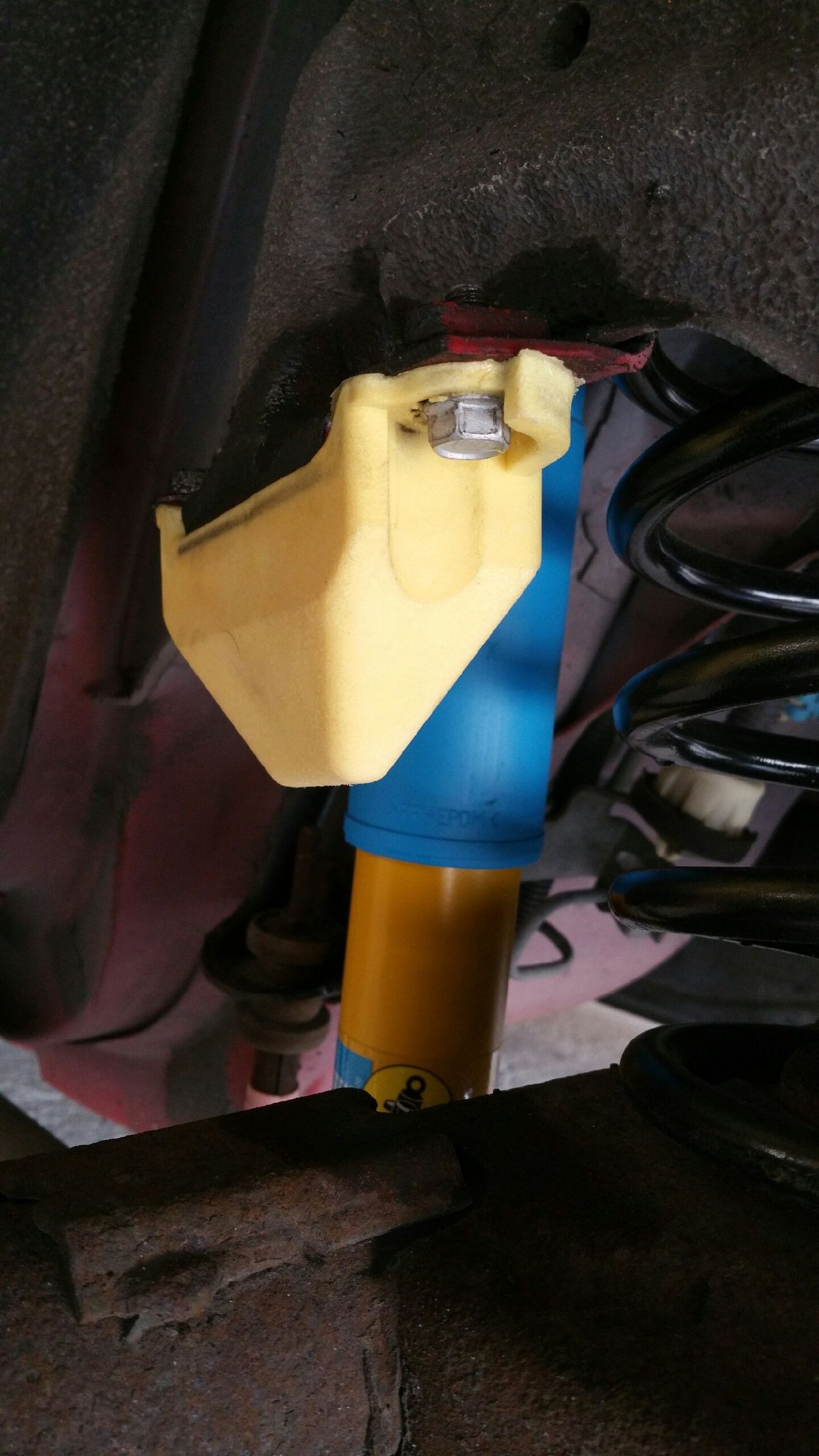

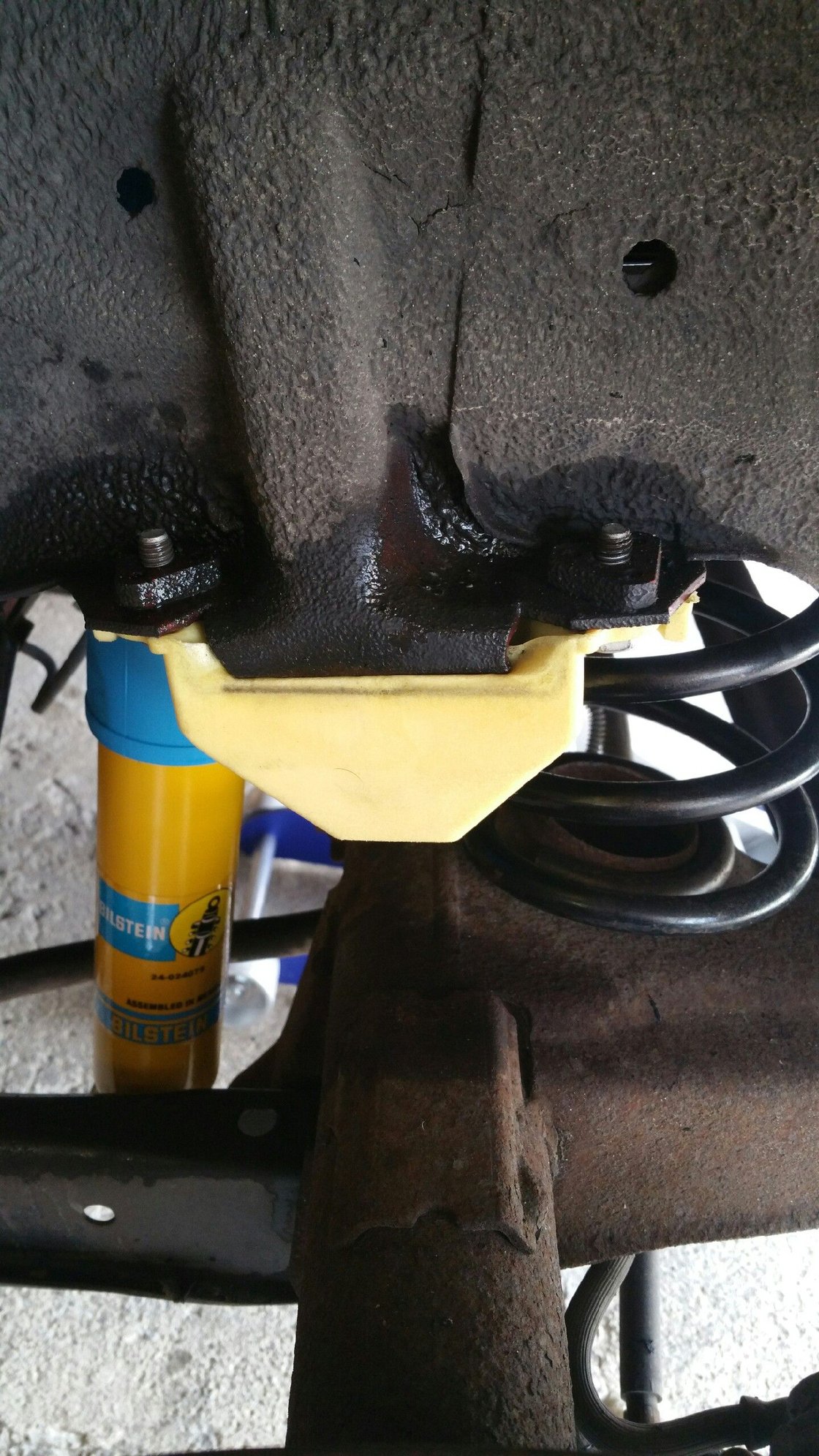

Fixed it. Even got new bolts from the Chevrolet dealership just because that’s how sick I really am.

Strano sells those, for $63. He also has “his own” urethane for $25. But he does note that the red urethane are the Jeep part that a lot of people buy.

If I would’ve known I would’ve bought them from Strano. Reason I didn’t want to buy the cheap Jeep ones is I didn’t want to cut the lip of the car off or some people make/add spacers.
I just wanted the GM OE bolt in ones.

I think the GM ones are fairly new product. Look better than the Jeep stuff.
I had to cut off the projecting edge of the original factory brackets to prevent my 17x11 ZR1/GS replicas from catching the inside edge of the wheel rim when jacking the car.
