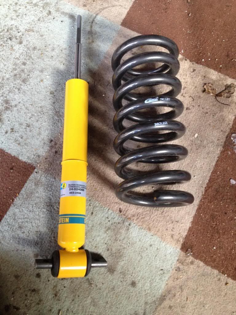

I'm about to start an install of new bilsteins/eibach pro's. It is now snowing here and friggin cold so I am trying to plan this and get it done quick. Other than the spring compressor tool, are any other special tools required?
Here is a pic of what I am attempting to install, bilstein be5-2406 with eibach pro 3801.201.
http://i1217.photobucket.com/albums/...n/DSC_0789.jpg
In comparing with the orig setup, it looks like I am missing spring mounts and these new Eibachs are a lot wider than the original springs. Are they correct?
update:
It appears as if I have the incorrect front springs. I bought these in a kit years ago and must have purchased the 3rd gen kit. crap.
