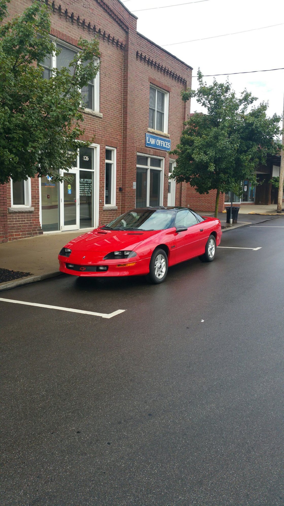

It will lift you sagging springs about an inch and sit exactly like an original 00-02 SS.
If you run the Moog 60116, CC635, and Bilsteins all the way around it will look exactly like this:

the moog did raise but it does settle some
