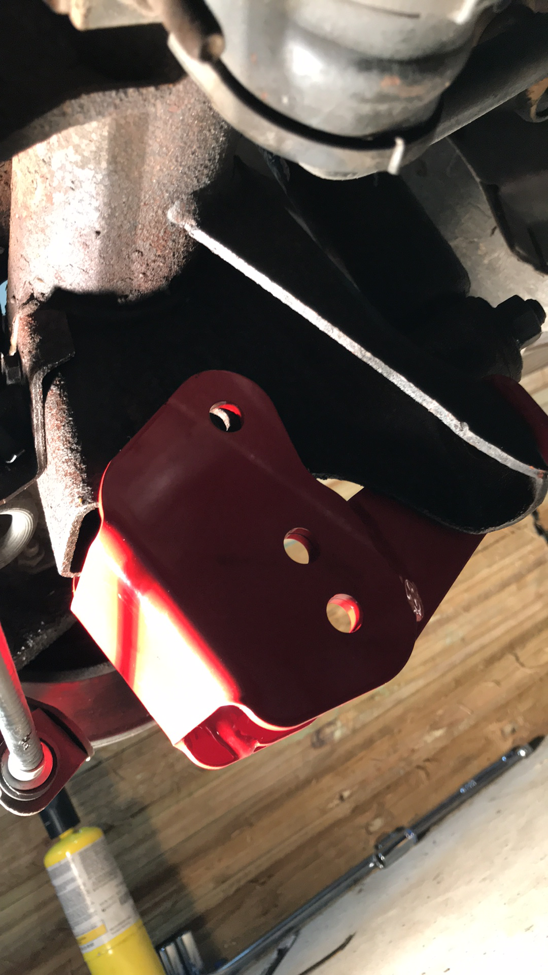

Replacing the LCA’s shouldn’t change anything. I can't think of a reason the LCA relocation brackets contributed, unless possibly the bolt holes are not drilled in an arc to keep dropping the axle end of the LCA from pulling the axle assembly slightly forward as the LCA’s are lowered. Some cheapies or Chinese rip-offs may simply have the holes drilled in a straight vertical alignment, rather than arced in a radius. Were these bolt-in or weld-in brackets? Are they installed correctly?

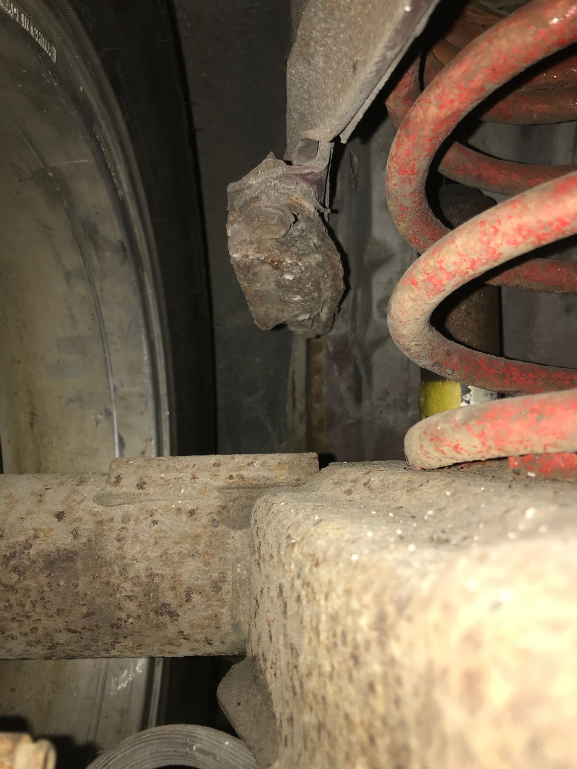

Old Dec 2, 2020 | 09:21 PM
grabbem88's Avatar
Joined: Feb 2011
Posts: 433
From: St.louis
Re: Added lca and relocation brackets now tires getting cut

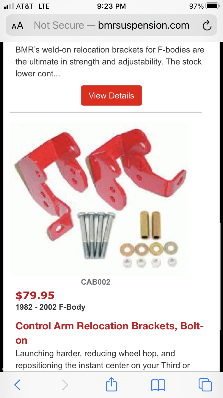

Old Dec 2, 2020 | 09:25 PM
grabbem88's Avatar
Joined: Feb 2011
Posts: 433
From: St.louis
Old Dec 2, 2020 | 11:42 PM
grabbem88's Avatar
Joined: Feb 2011
Posts: 433
From: St.louis

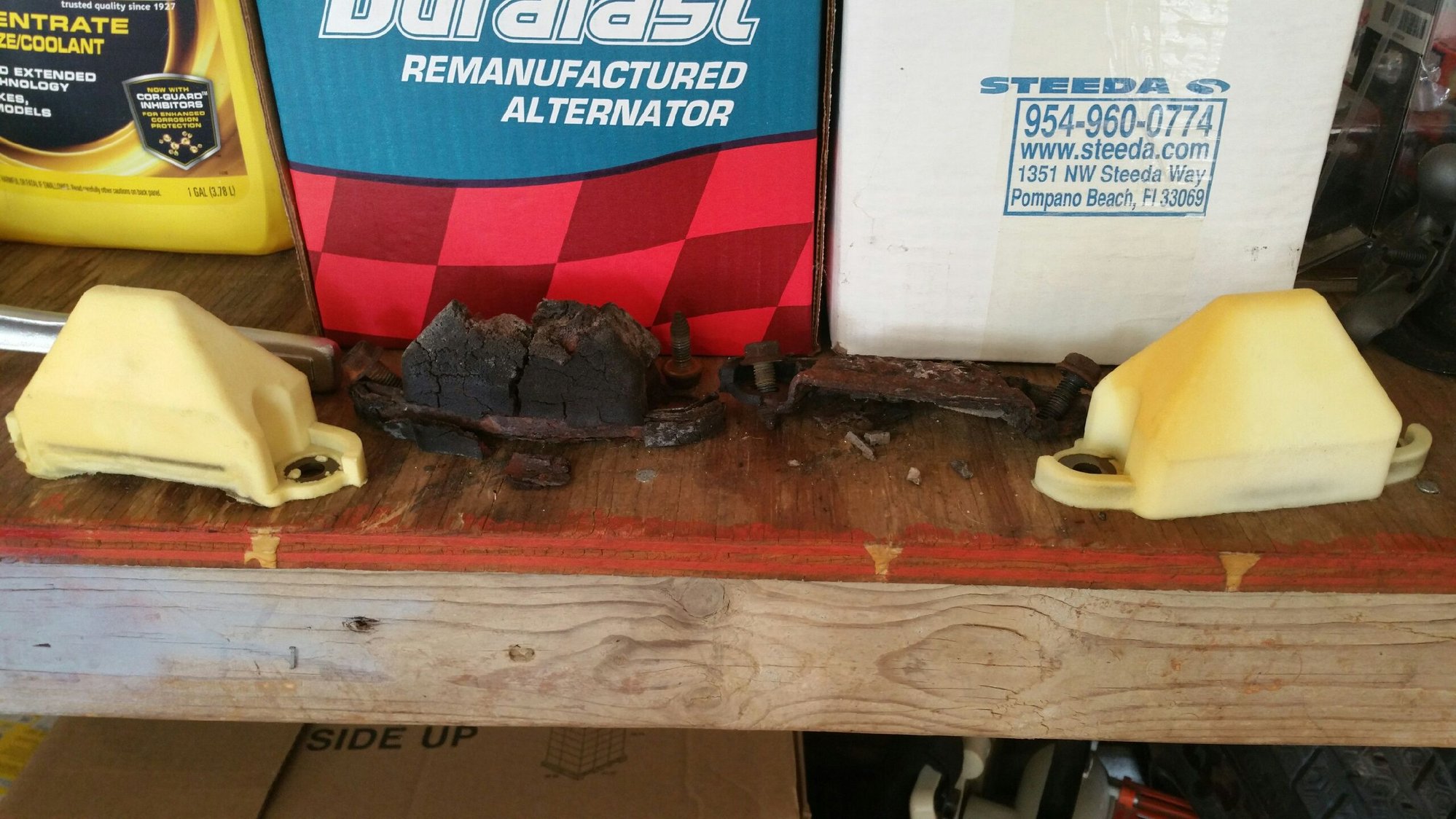

No bump stops either lol got lots of work to do
shocks look old too

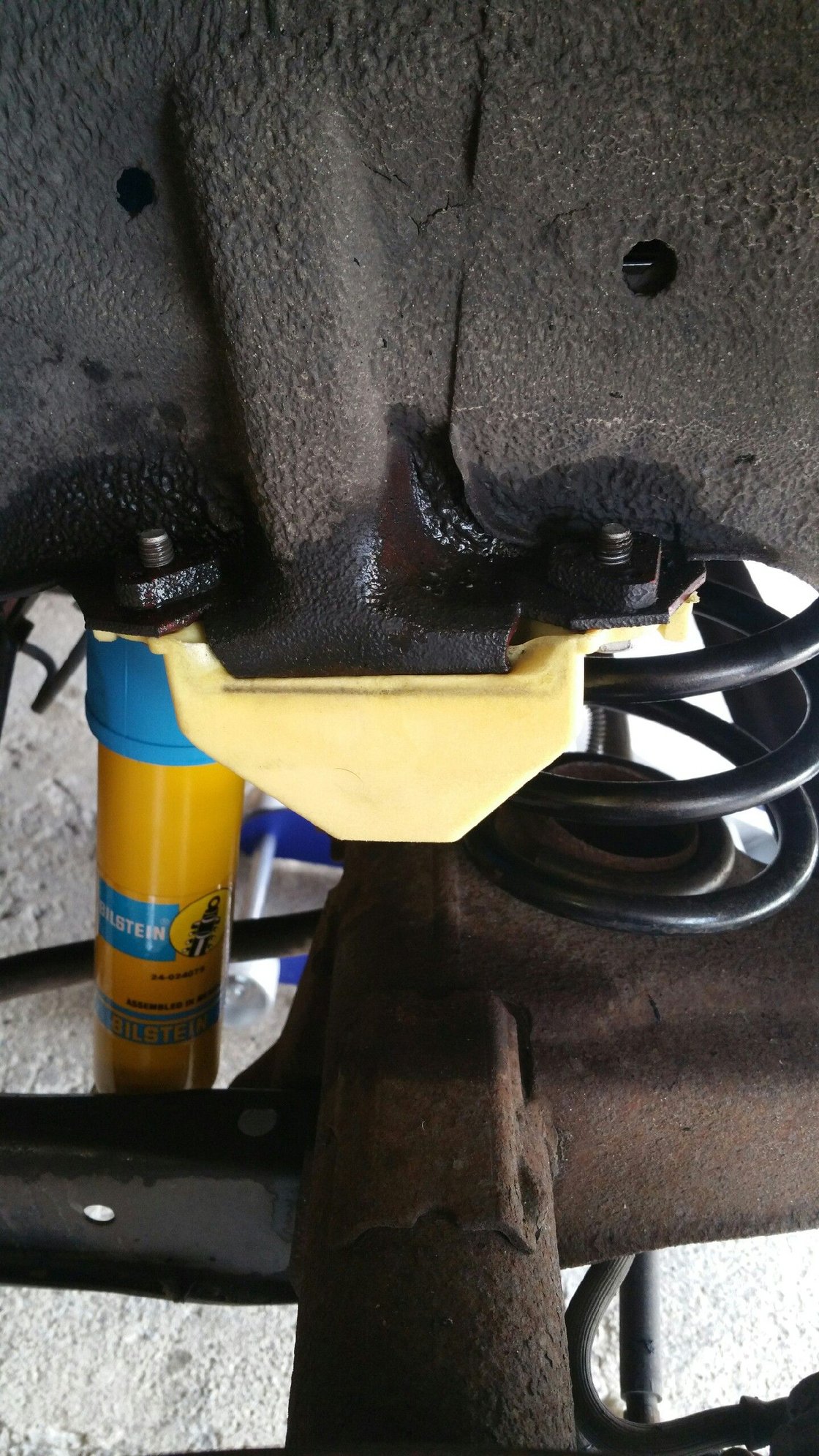

Old Dec 3, 2020 | 05:54 AM
Germansheperd's Avatar
Joined: May 2019
Posts: 181
From: Wooster, Ohio

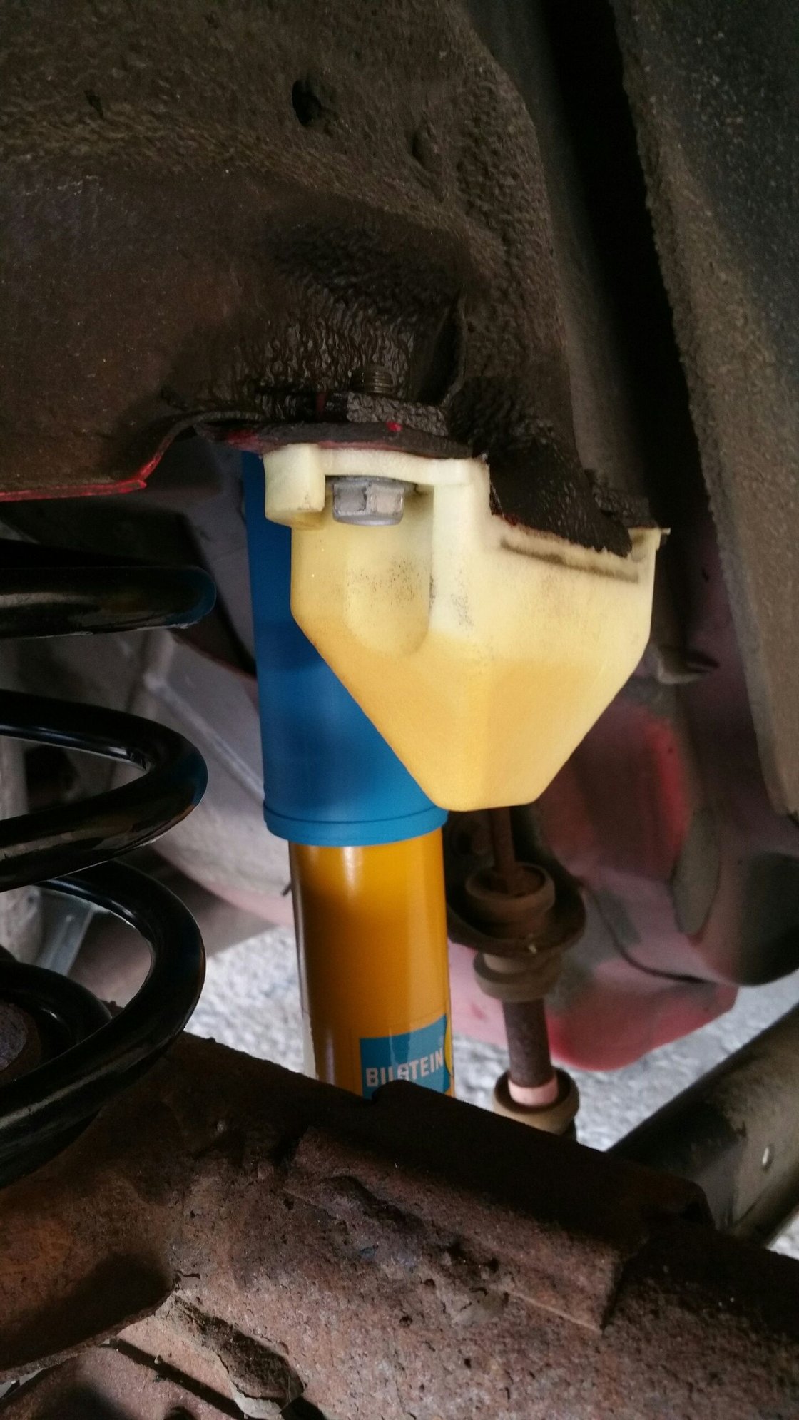

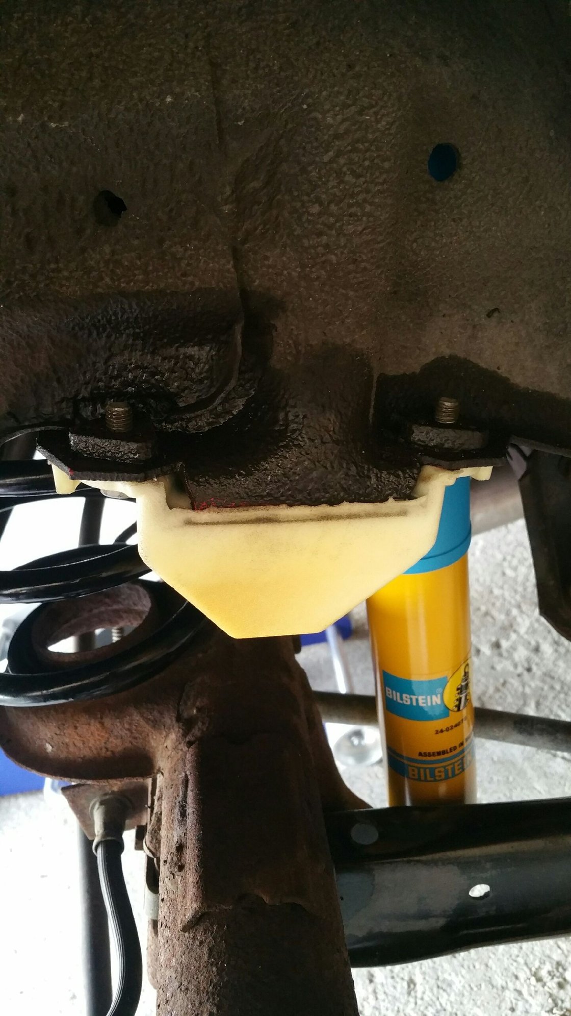

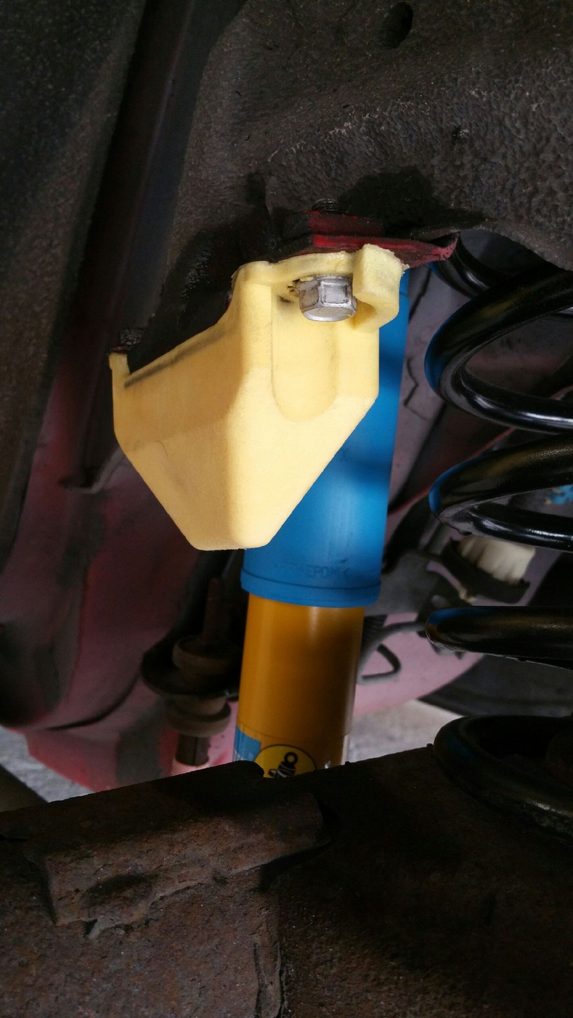

I just did new Bilsteins, 02 WS6/SS springs all the way around, and new bump stops earlier this year. I can’t tell you how much of an improvement the ride and handling was. If you would’ve told me prior I wouldn’t have believed it.

The BMR relo brackets are fine.

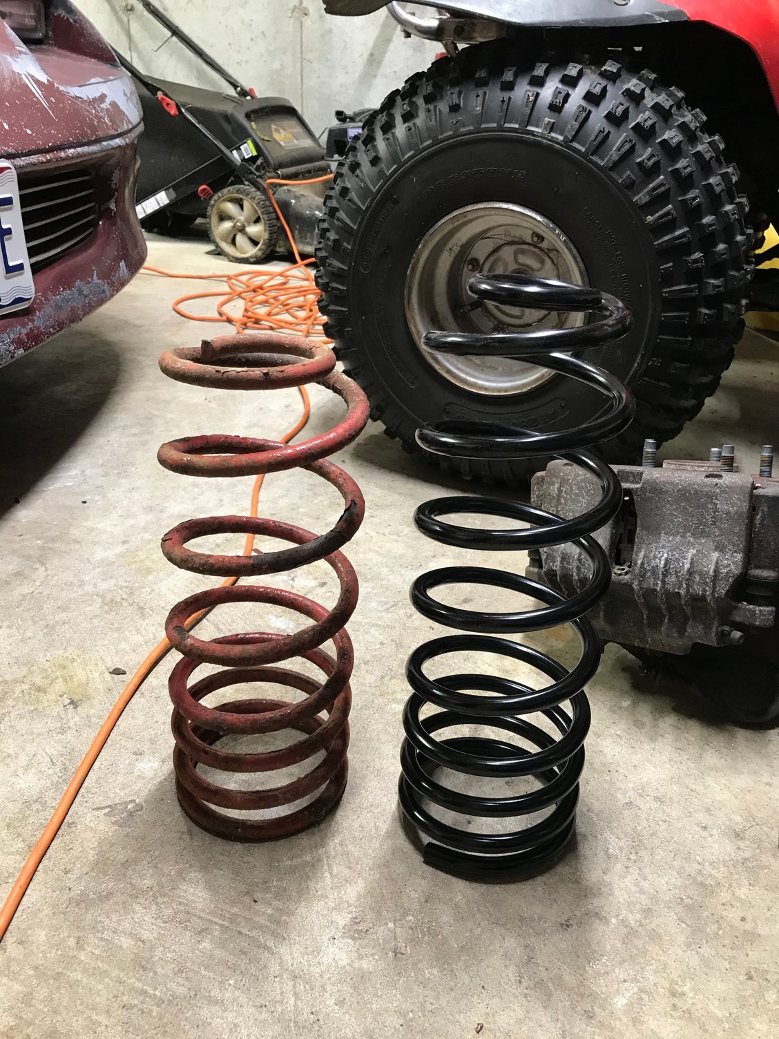

Fixed! It was my springs I can back straight out and it handles better
