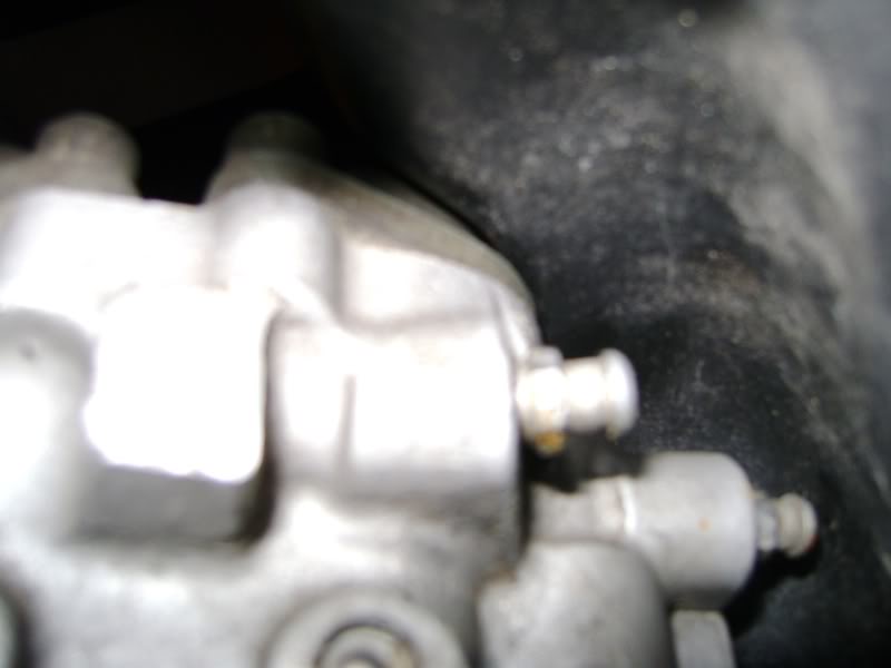

front of the abs unit are 2 bleederscrews
where is the abs unit located because i dont see anything with 2 bleeder screws
Old Mar 28, 2009 | 01:45 PM
Wims97T/A's Avatar
Joined: Feb 2005
Posts: 67
From: Amerongen the Netherlands
Just remove the duckting from the maf sensor to the airbox,then you will find these 2 bleederscrews
Old Mar 28, 2009 | 04:29 PM
Posts: 71,122
The ABS unit is the huge, clucky mass of aluminum that that lines from the master cylinder connect to. In this photo, its at the top/center of the photo:
