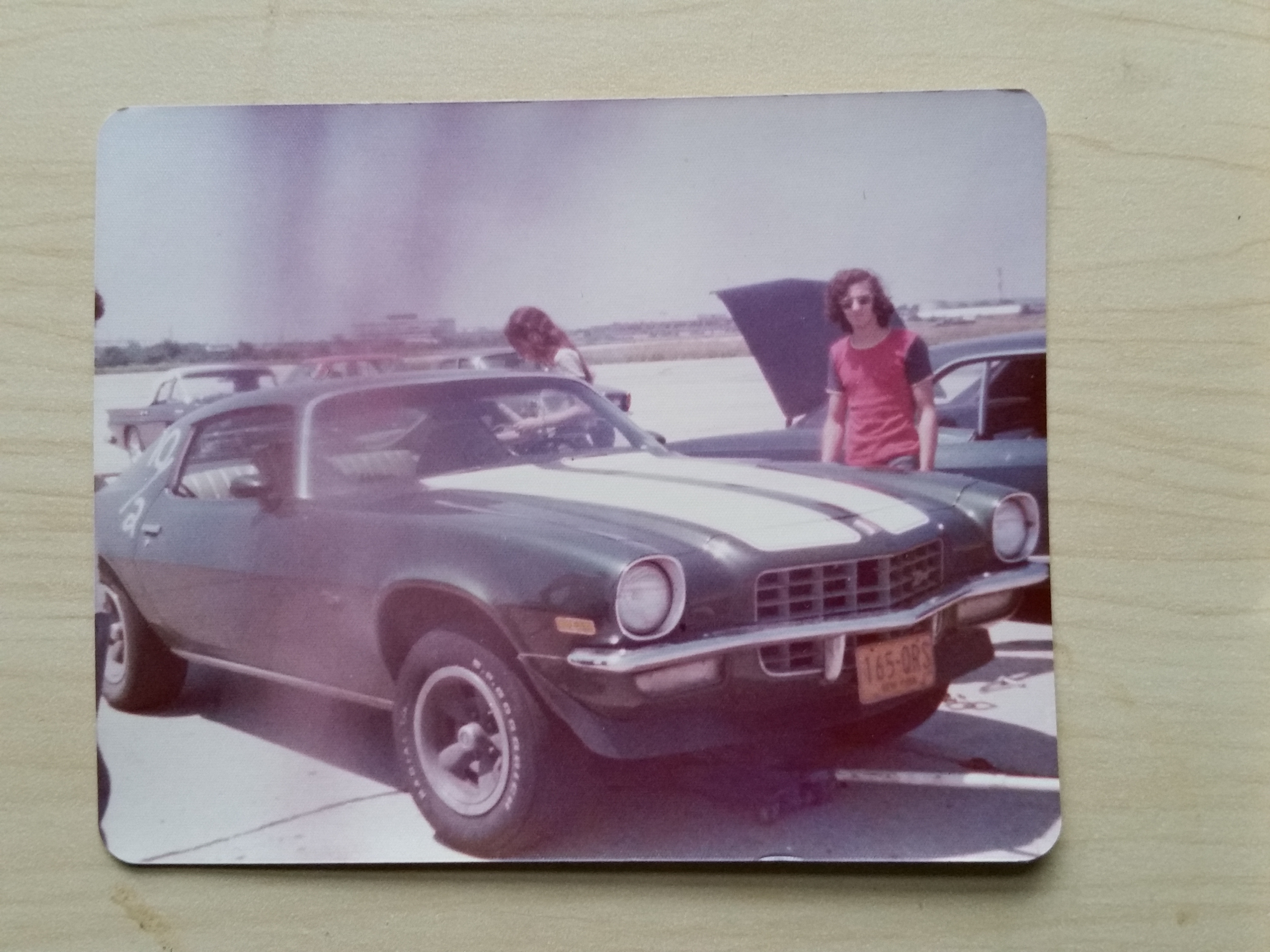

My first camaro was a 72 z28 (3 others since) . loved the car. bought it in 73 so it was hot at that time. whether its a good project to undertake , thats up to you. if you are looking for a 70's muscle car go for it. if its rust free it sounds like the price is reasonable. a numbers matching engine would add to the value. a 70 LT1 was a solid lifter 4 bolt main 11 to 1 compression 350-370 hp. in 71 due to the gas crunch it was basically the same engine - 4 bolt main solid lifter but it had heads that had larger cc's and flat top pistons that dropped the compression down to 9 to 1. so was the engine swapped or was it rebuilt to 70's specs ? those cars were much easier to work on compared to newer ones. mine had no power steering, no power brakes ,no a/c and manual crank windows LT1, close ratio 4 speed, posi 373 rear. . as simple as you could get. if i could be of any help just give me a shout. good luck
Al
