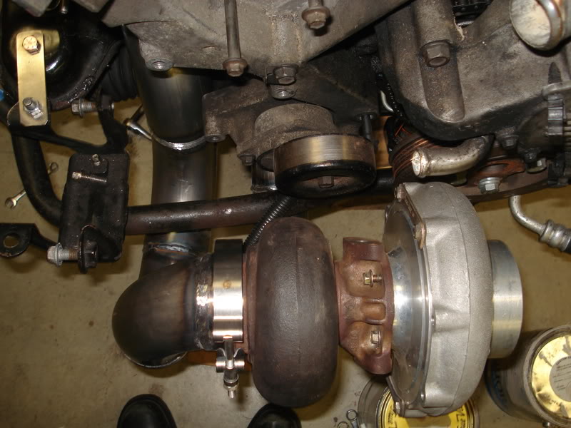

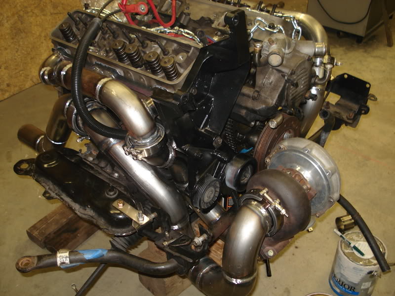

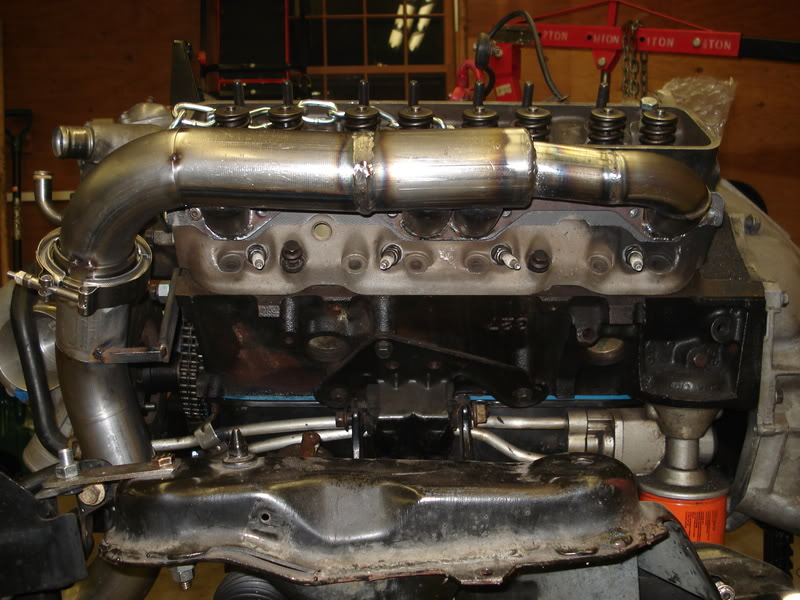

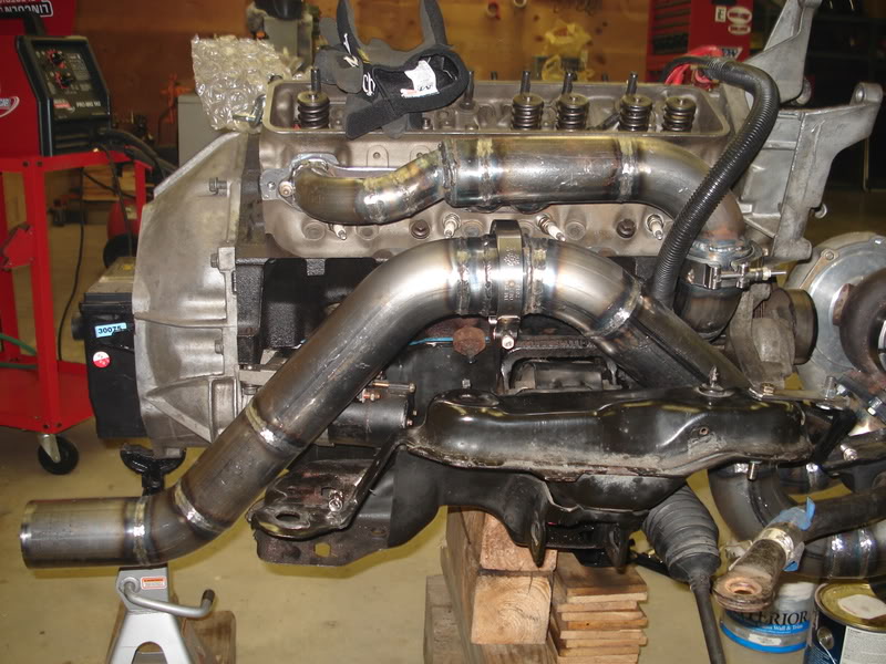

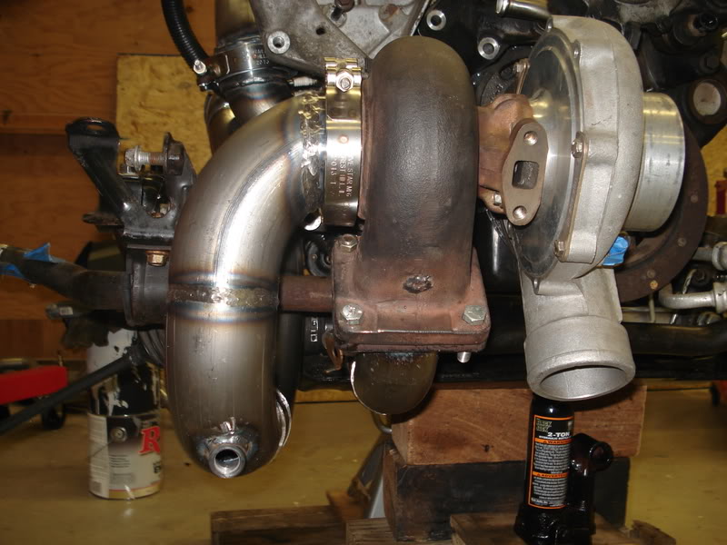

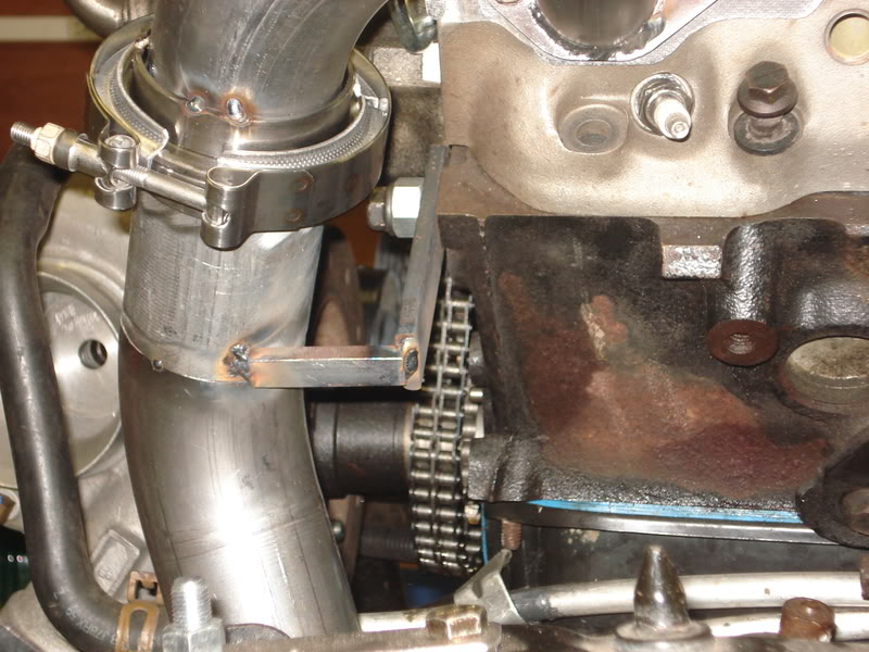

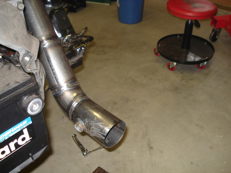

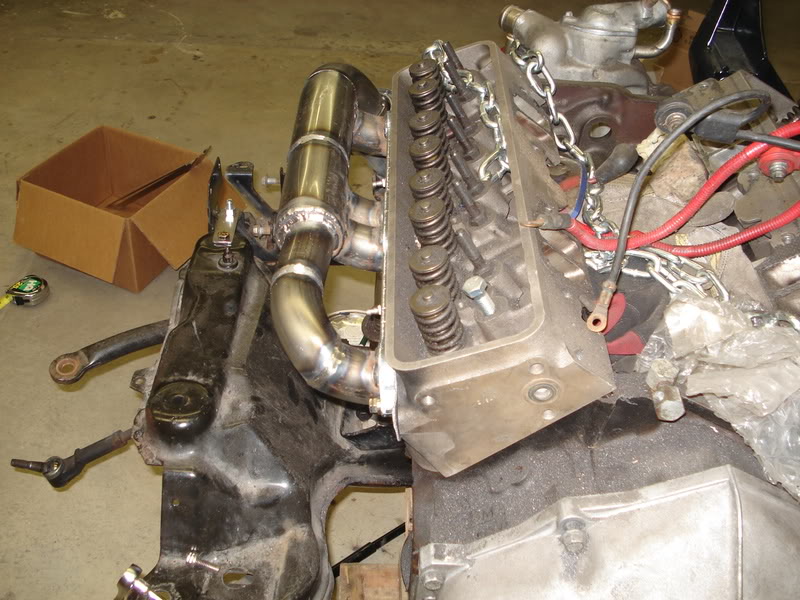

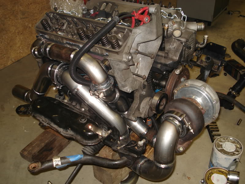

Some progress pics of the Twin turbo setup I am making. This kit will support T4 T60 thru T76's and will support anywhere from 700rwhp to 1100rwhp depending on which turbos you use.
The goal is to retain the radiator in the stock location, thats why i mounted them low. You will need to run an oil scavenger pump(s) to push the oil to the pan (or up to the valvecover like the STS kits do). This kit deletes A/C and the AIR pump, but other than that everything else remains. I still need to do some grinding and clean up work, but here is the layout of the pass side.

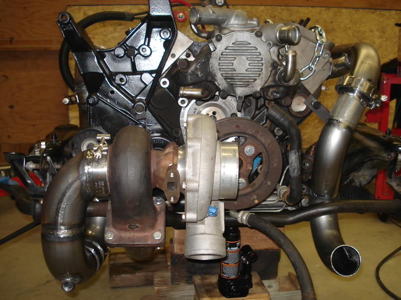

Some updated pics... I am stuck where I am until i receive some more turbo flanges.
