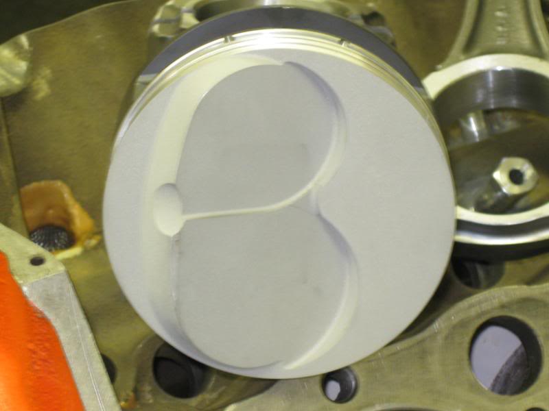

Ross makes good pistons. Mine have the domes ceramic coated and the skirts have a low friction coating. Plan on spraying between 175 and 275 on it.
