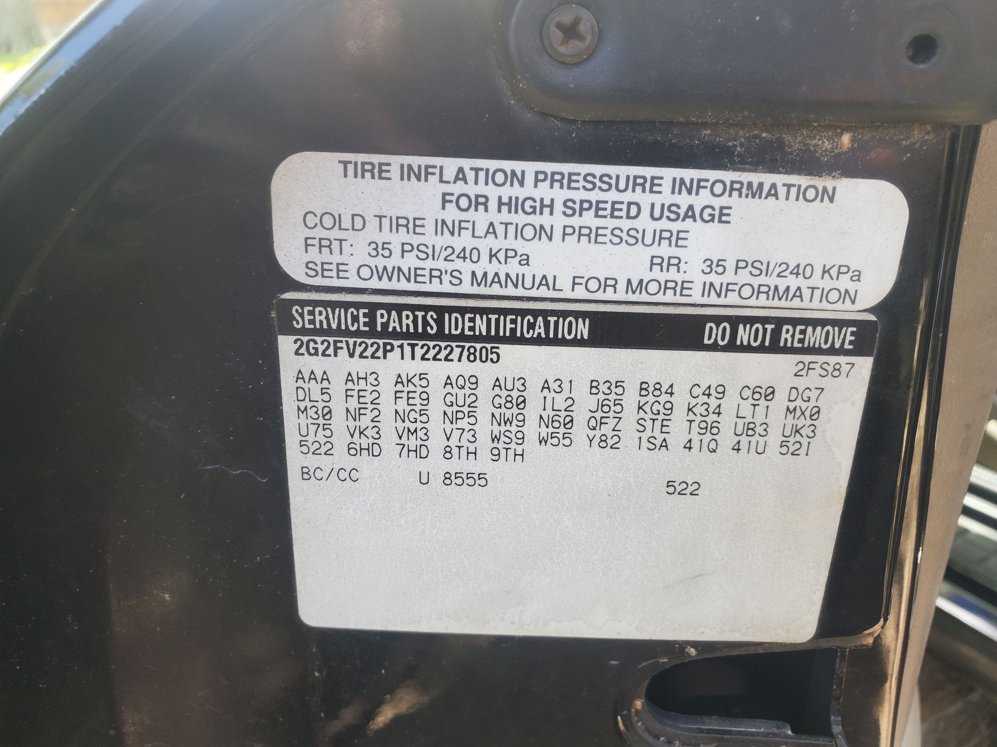

They're 16s...I miss read it. Heres the labels.
Old Jul 27, 2021 | 07:59 AM
DrewHMS97SS's Avatar
Joined: Sep 2003
Posts: 1,917
From: Las Vegas
Re: Tuner Input?
With no emissions, long tube headers will provide the most performance. Additionally, if you need to replace the cats, long tubes make it easier to eliminate them.
Shorty headers are only slightly better than the stock manifolds, and from experience make everything harder to work on; mainly plugs and wires.
EGR and air can be eliminated if you are looking to clean up the engine bay as Fred stated, but there is no power gained, and only a couple of pounds dropped. This is needed info when ordering headers. In my opinion, headers without emissions fittings are much cleaner.
