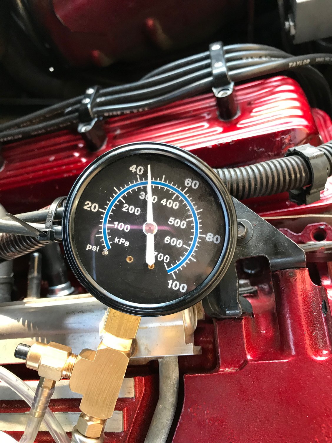

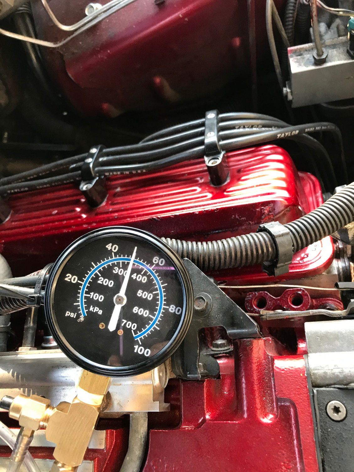

Old Dec 19, 2020 | 02:32 PM
  #105
grabbem88's Avatar
Joined: Feb 2011
Posts: 433
From: St.louis
Re: Is there a such a thing as cam surge in sd lt1’s
Originally Posted by Injuneer
Then your fuel pressure shouldn't be:
Btw here is my fuel psi one with vac other pulled not sure what to tell you other than the motor is sound
Fuel pressure should be varying with throttle movement, and should drop significantly on closed throttle decel (high vacuum),
Something doesnt add up here.
instead of coming off as a dick you should of asked for clarification instead of copy pasting to smush in my face like I’m an idiot.
