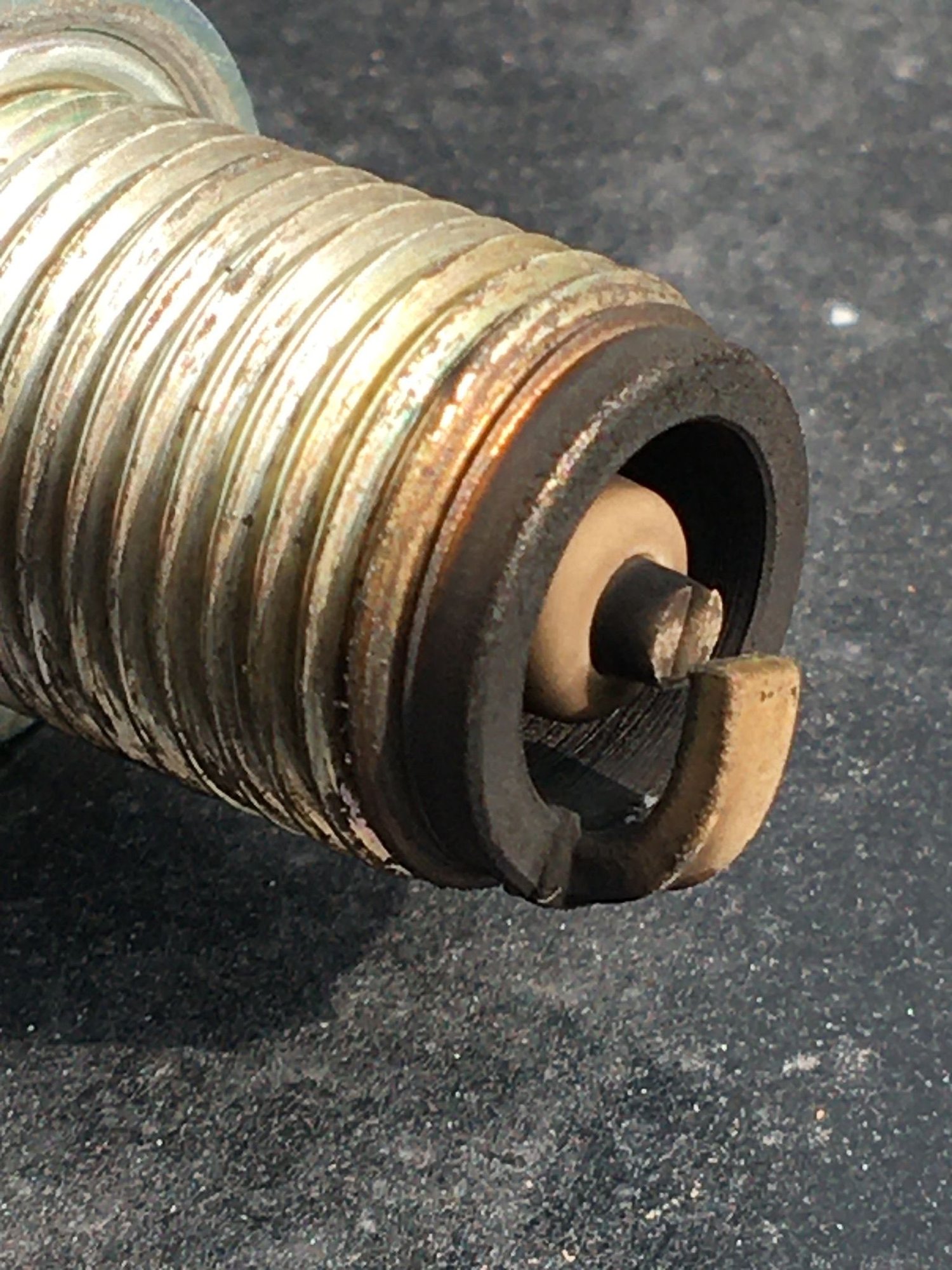

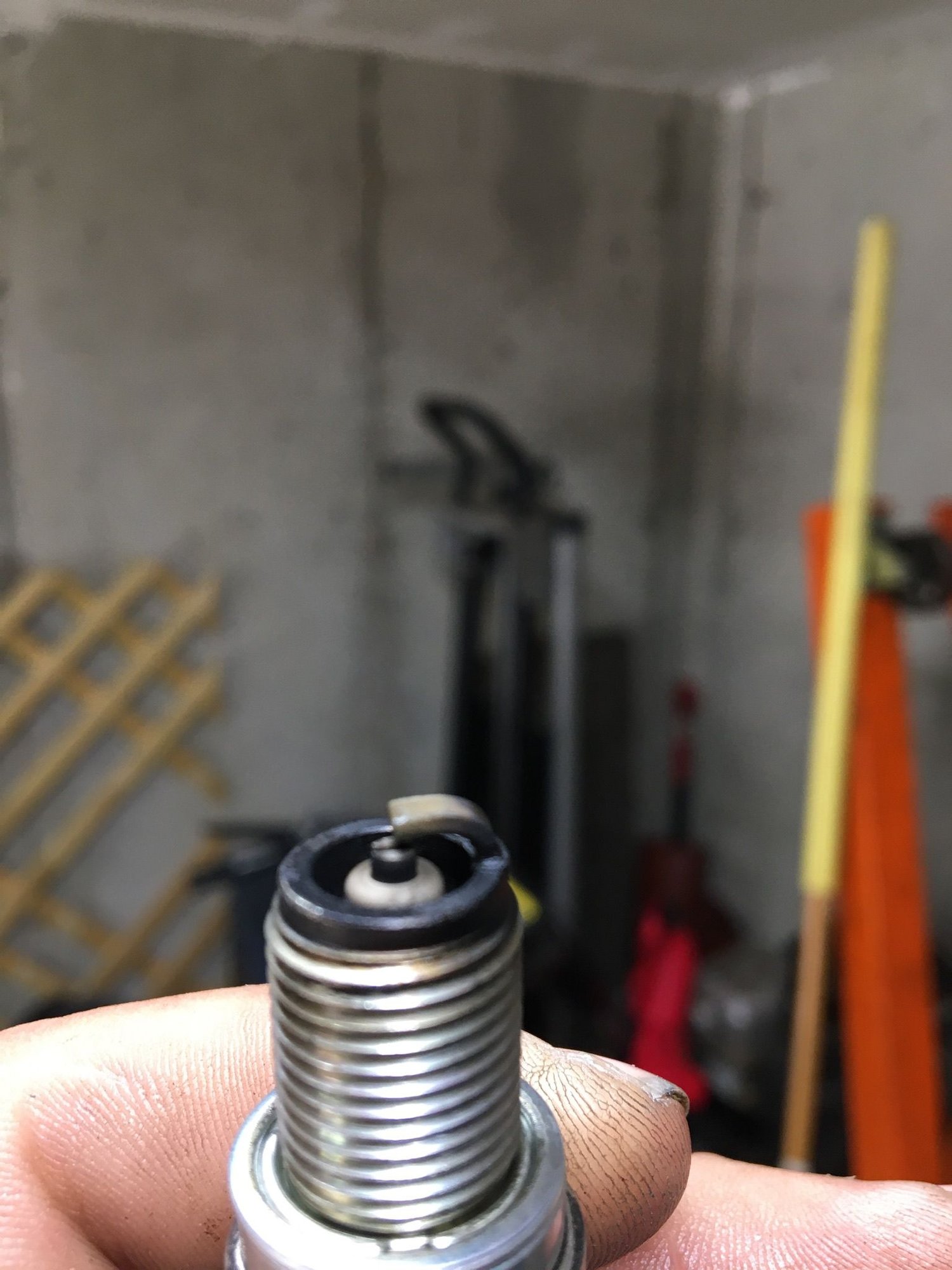

I have the two original bins per each tuner
the rest are what I’ve been piggy backing off of per pcmforless tune
the Solomon tune hasn’t been messed with that much. And was my dyno results
btw all my plugs look or have looked like this all 24 plugs
