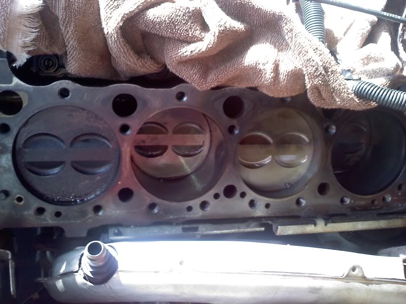

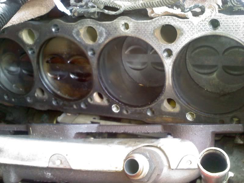

Mind if i take some pics and maybe you could help me figure out what positions which pistons are in?

Sure, easy enough, but there will always be two cylinders at the top at the same time. As long as you know which cylinders are which (if you dont, look here), it should be obvious. The position of the cam is what determines which of the two is actually at TDC (compression stroke) for firing. The intake lifter on the cylinder that is going to fire would have just gone up, then down and the exhaust lifter would be down, as well (indicating both valves closed).

1,3,5,7
3,5,7
2,4,6,8
4,6,8
Thanks shbox

Rotate it until 1 and 6 are at the top of their bores.
This shows the cam position for all firing positions:
http://shbox.com/1/cam_timing_ani.gif
