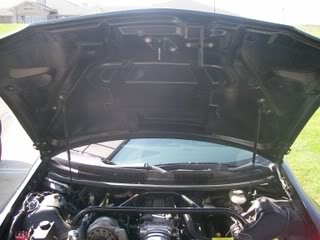

I don't know what kind of manifold he was running, but this all fit under the stock SS hood. There were some modifications made to the internal structure of the hood though. Engine was a Dart Iron Eagle SBC with Brodix heads.
http://www.injuneer.com/images/photo.../DCP03825a.jpg

I have a super vic with a custom elbow and a 90mm acufab t.b and it kinda clears the stock hood(not ss stock z28 one)
I had to cut some of the bracing on the inside of the hood and the hood still touches the t.b when closed but it still closes
I plan to get a new hood eventually but but its a ways down on my priority list

I will try to take some pics of my setup over the weekend. I’m running a World Products single plane, Wilson Elbow and a NW 90MM LS1 TB. I had to cut some of the bracing out where the back of the elbow hits the weather-stripping. I also had to cut the area out under the scoop. I will take some pics and it will show what I’m talkin about.

I like the 90 degree elbow with a 90mm TB versus the 4 barrel style. Here are pics of my setup, along with what had to be cut on the hood....
Nick

The Procharger hat won't fit under a stock hood pointing forward. It will almost fit if turned to the passenger side, towards the firewall. That would still require milling the the surface that mates to the TB on an angle so that it tilts down slightly. At least that's what I found on my Accel single plane & 4bbl style TB.
I was able to take the Accel 90 deg elbow, and take a pie cut out of it tilting it down to fit.
