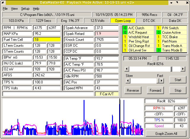

Maybe someone here can help me out, or knows what is going on.
My rev limiter is set to 6130, but I did a data log a couple of days ago and during the 1-2 shift the log shows almost 6400 rpm. It never hit the limiter and shifted cleanly. So what's going on here?
It's a bit concerning to say the least!

and I kind of found out why this was happening, but don't know how it ended up that way. I pulled the tune from the car and the fuel cuttoff and resume were both set for 6169rpm. I looked at the bin that I had saved and it wasn't like that, so I either screwed up somewhere or who knows...
