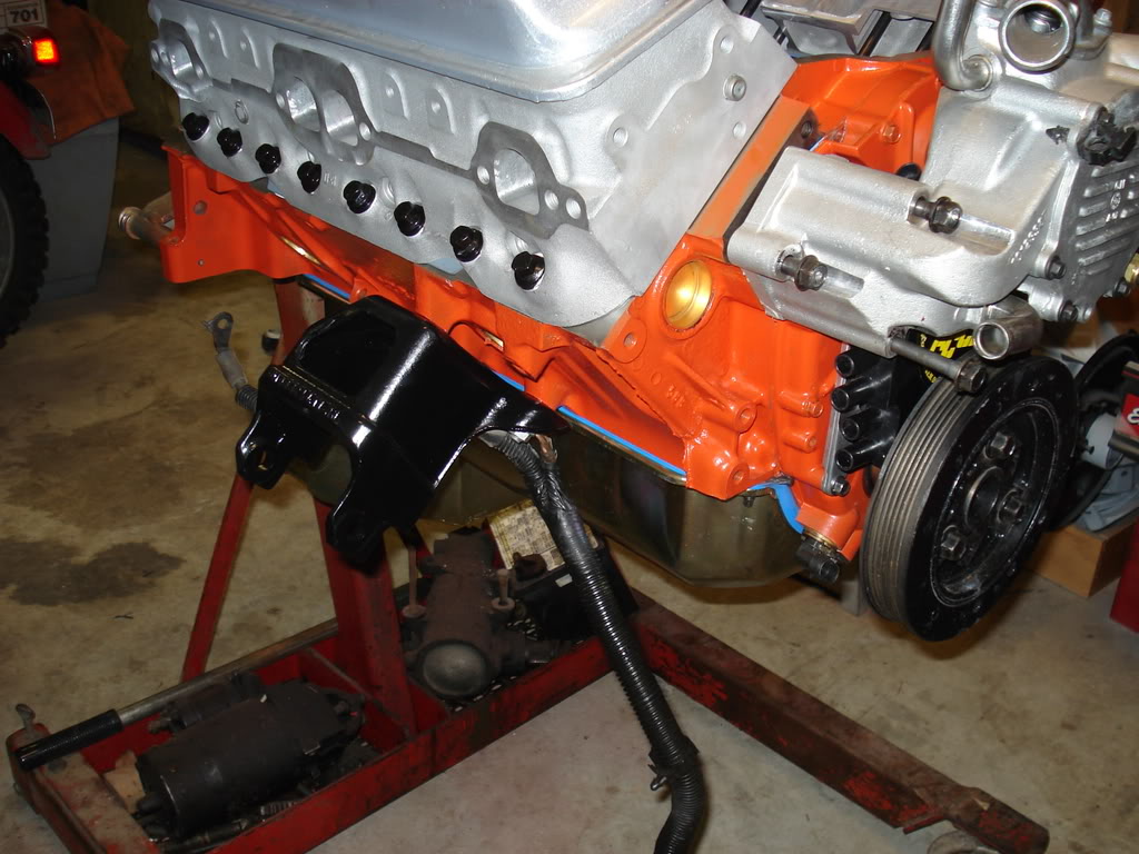

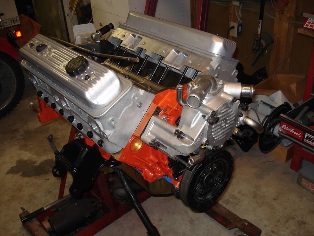

Does anyone have a picture of the Passenger side of the block? I've looked at shoebox's website and didn't find a big enough picture.
I have a big coolant leak either at the knock sensor, heater hose, or cylinder head steam pipe. I need to know what else is down there.
Hopefully the head gasket isn't blown.

These are the best of mine I could find.
