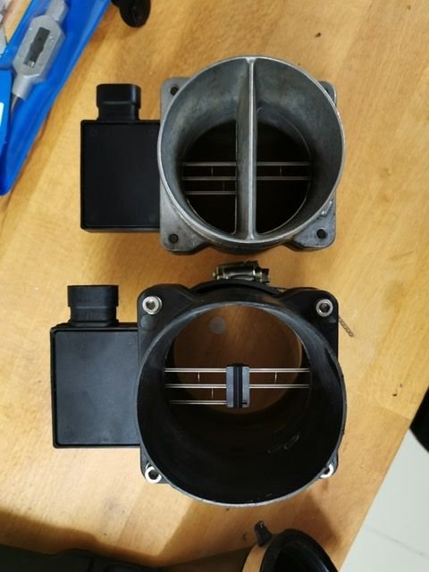

which MAF is this?
When I bought the car the stock airbox was bolted in. The MAF has the numbers 83191172559 but it could be that there are a few numbers at the beginning missing (sticker is scratched) Can anyone tell if this is the stock MAF? Kinda strange because when I browse for the Delco MAF I see a plastic part...
Also got the Moroso CAI and a Grantelli MAF (89873872257, should be optimizer for the CAI?) with the car. Is this any good?

don't use the Granatelli MAF, period. The arrow on MAF should be pointing towards engine if it is not. It should also have the screen in it

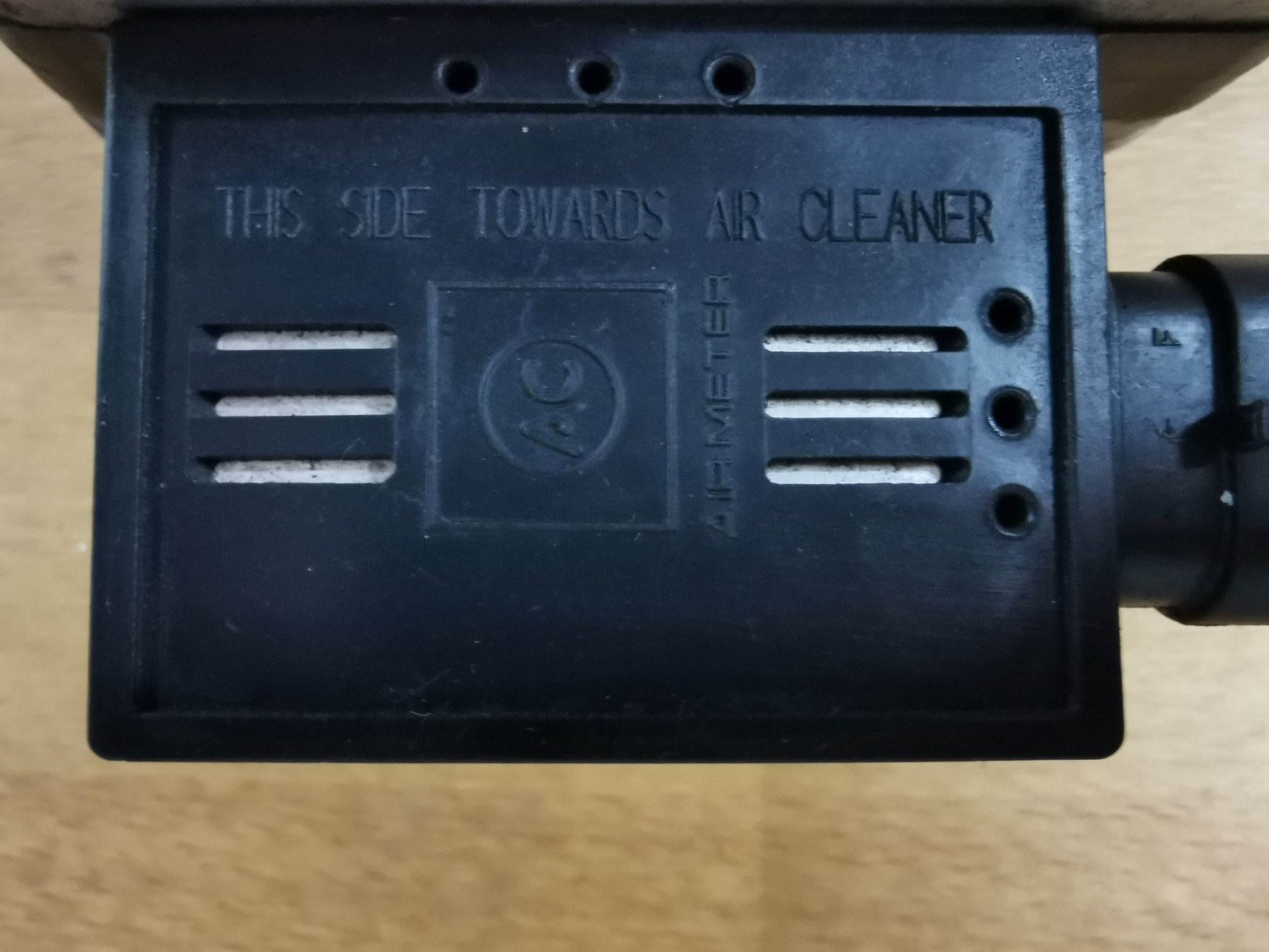

close up of the unknown MAF

tried the Granatelly yesterday and today but due to bad reviews here I decided to put the other one back in because its my daily and has to work without problems

The Granatelli can be "made" to work but requires PCM programming and in the end provides no gains so just use a F-Body GM MAF. The screen is to "uniformly stabilize" the airflow across the wire sensors so you want to keep it in vs removing.

you donˋt happen to know what kind of maf the other one is? i mean if it is a stock delco one then there should be delco written somewhere, or am I wrong?

I have the original MAF sensor from my 1994. The number under the barcode has 11 digits, so it looks like you have the complete number. The number on mine is 82410121129. And no FLOW arrows. But otherwise the appearance is identical to your photos, assuming the inlet side of yours still has the screen in place.
As I recall, there was a change made sometime after 1994. The 94 has a spring ring in a groove holding the screen in place, making it easy to remove without damage. The later version had the screen fixed in place, in a way that requires destruction of the screen to remove it. That may account for the bar code number being different. But neither bar code (yours or mine) seems to tie into the actual part number.
In any case, do not remove the screen. It affects the calibration of the sensor. Mail order tuners don’t want to see a screen removed.
As I understand the Granatelli MAF, the electronics were modified to under report the actual air flow.at very high flow levels. That leans out the A/F ratio at peak RPM, where the stock tuning sets it on the overly rich side. Problem is, the modifications didn’t seem to be reliable, and often they cause more problems. I haven’t seen anyone even mention the Granatelli for at least 10 years. Leaning out the too rich stock target A/F is easy to accomplish in the tune - something a DIY tuner can do using calculation formulas available online. Or a mail order tuner. Good for 10-15 HP.
PS: The “AC” is often used on AC Delco parts.
