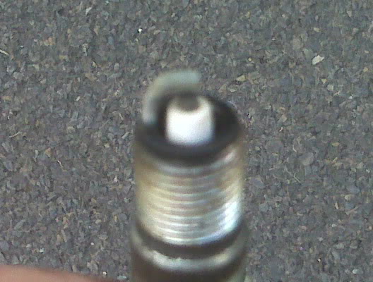

Here's a picture of one of the plugs.. none of the wires are burnt

I can hear whatever is going on on the right side. Its a slight woosh noise almost like a little bit of fuel may be hitting the header. Its real hard to pick out but noticable when im really paying attention. The picture of the plug is from cylinder #4 on the passenger side. I just looked under the hood in the dark and do not see any arching in the dark. I had to replace the left O2 sensor last year, but the right was functioning fine at the time. Do you think the right O2 is starting to kick?
