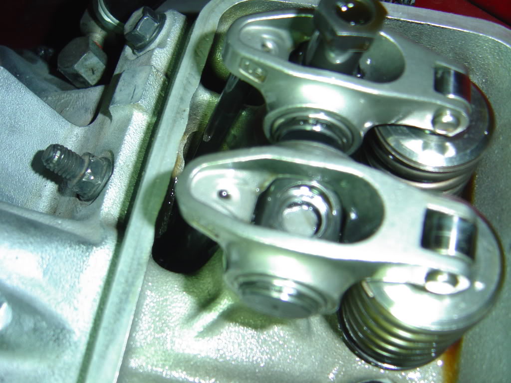

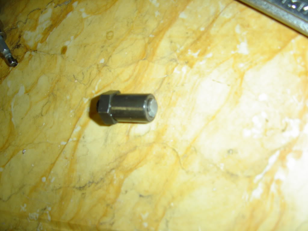

Haven't had the time to mess with this much until today....driving home it developed a loud tick and started running horrible. Popped the valve cover off and now its even more confusing......
The rocker stud snapped in half, what's odd is the location in which it snapped, just above the rocker truion almost even with the bottom of the polylock.
In all of the changes over the past few months, I forgot it probably was not a good idea to run the heavy dual springs with 3/8 studs, but if that was the cause, sure is in an odd spot.
I'll be measuring the longer PR at 7.50" while I'm at it, and switching back to the beehives and almunim rockers..along with some slightly longer and new studs in case the others are stressed from the bigger springs.
(Went to the 3/8 studs when I went to the SA rockers...SA only comes in 3/8...)
Here's the pics of the breakage
