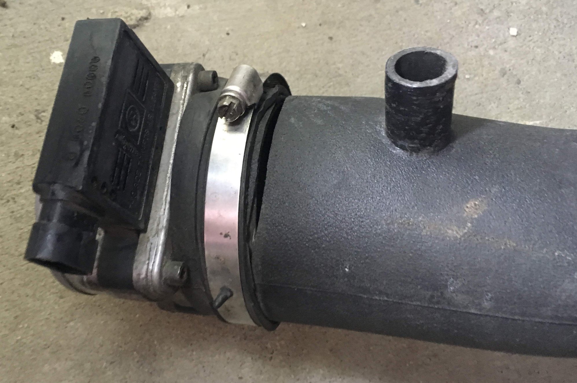

Still riding on that high from getting the car to idle. I was concerned I had to drop the tank and do a fuel pump job.
I went to clean the MAF and look at what I found:
Intake Underside Split Open, not visible and actually can't even feel it when it's aligned
Right in front of the MAF. The entire rim of the plastic is rotted away and crumbling. I had to cut it out and trim it back about 1/2" with a dremel and I gorilla taped it like crazy. Will be replacing the intake in the future anyway

If that crack is "before" the MAF it would not matter much other than unfiltered air entering engine...if after than it is "un-metered" which will certainly mess up air/fueling

That looks like the pre-MAF intake ducting. It could have caused a really dirty MAF.
You can by cleaner at the parts store for the MAF, but will need to remove the screens to clean it. Be EXTRA careful with the spray and a q-tip, then let it dry for 10-15 minutes before reinstalling.
