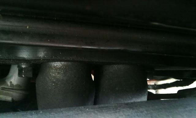

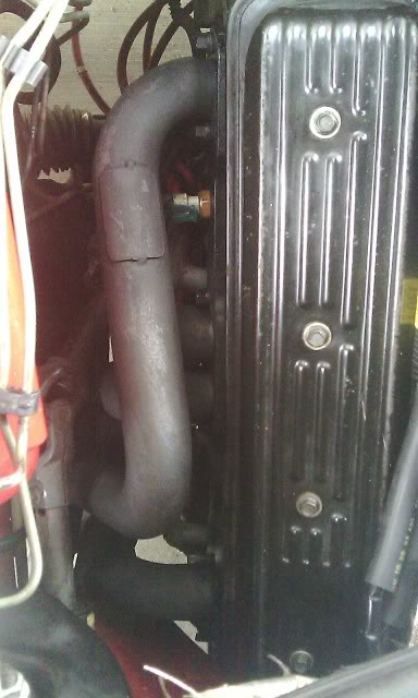

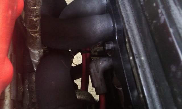

it looks like it should go in.. but 4 hrs of header tetris and NO GO. Should I cut ALL places I need to make them fit? I may need to cut a half inch off the bellhousing, half inch out of the k member, and I still can't loosen that steering enough.

The first thing I notice is you still have the steering linkage in... its 1 bolt and it slides out, that should give you room there. The passanger side is another story. I pulled the motor mounts and jacked the engine as high as it would go and then started pushing upwards as hard as i could, it wasn't easy and car was on jackstands as high as they could go.
Old Mar 4, 2010 | 09:23 PM
LearJet's Avatar
Joined: Jul 2007
Posts: 459
From: Daytona Beach, FL
I undid both motor mounts when I put mine in. I was installing new poly mounts at the same time though so I don't know if it's neccasary or not, but it sure did make it easier. I was on a lift too, that helped a lot.

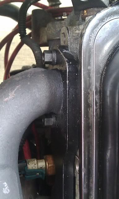

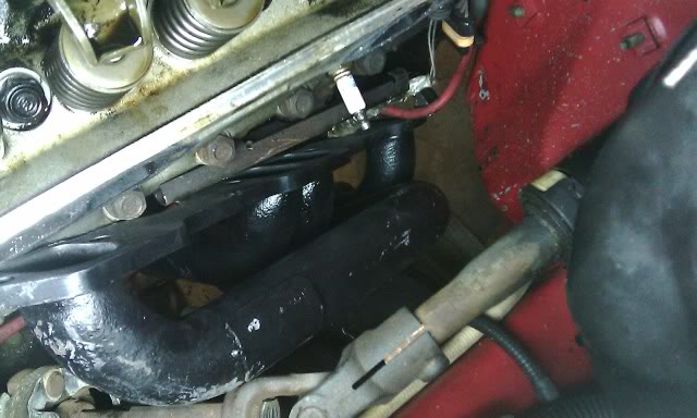

OKAY done. steering linkage came out after I broke it loose. The only way I could get it in was through the top. slipped right in. Now the next problem, how in the world do I tighten the bolts!? the tubes are WAY too big next to the bolt holes in the flanges. NO socket wrench will fit in any way. worse is there is no room for a combination wrench either! pics in the morning

If your using stock bolts, that won't work. Get a set of locking header bolts, I believe the head will be a smaller wrench size. On some of the bolts I remember getting like 1/12 turn at a time... turn/flip wrench/turn/flip wrench

Use Stage age 8 lockings bolts. You can use a 3/8 wrench or even an allen wrench. Best header bolts ever. A ball end allen wrench will get into tight places.
Also you might want to buy some cheapo allen wrenches that you can cut down for better clearance. Many guys also grind down the outside of an open end wrench to better get it on bolt next to the tube.

I can get to almost all my header bolts with a 1/4" drive ratchet, some with a small extension, some without. The rest I get to with a wrench.
However, when I had shorties I did have to make a custom wrench (I ground it down to make it very thin - it looked like a tuning fork )
I agree.
I used ARP 1" bolts with a 12-pt. head and a thin-wall socket.

I just bought some from the local speed shop :/
the stockers, yeah those DO NOT work, these are all 11mm's, real skinny and are finger tight. I can start the car without an exhaust leak but they aren't torqued and I have no idea how to do it... order new bolts? anyone have a link to some with the most clearance?
