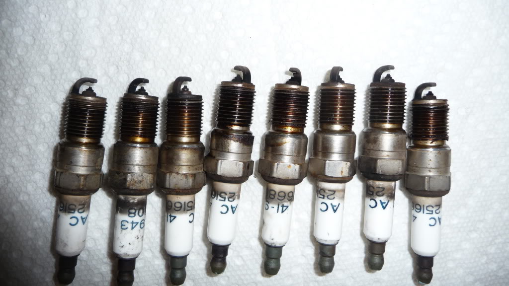

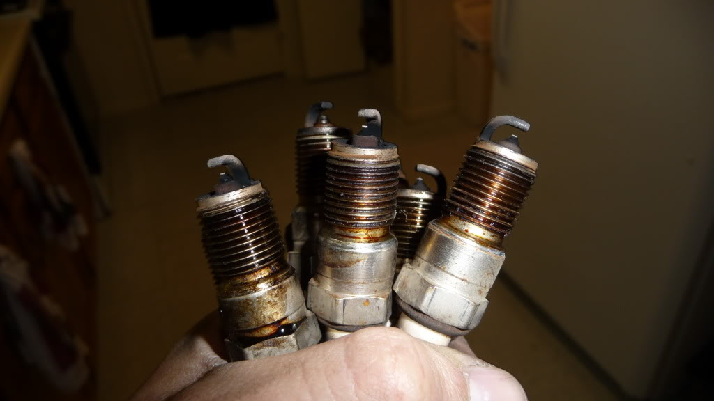

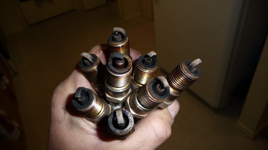

Well i changed all of the spark plugs and man was that a pita. I mean god i didnt unbolt anything and it took me 4hrs. Changed belt with gatorback v and the spark plugs were all black and had a black sticky residue on them.
So when i started it i thought it ran good when i increased the throttle, but when i hit the gas real fast then let off it backfired and seemed like it wanted to stall. Also i went to the back and there was water coming out of the passenger side tailpipe. The car has sat for awhile so im hoping its not a head gasket leak. Here are some pics of the spark plugs. Tomorrow i should get the wires and i will install them, i let the car run in the dark but didnt see anything that would throw a red flag. god this is so confusing lol.

Water is one of the main components of the combustion gasses. Completely normal for water to collect in and drip out of a cold exhaust system.
