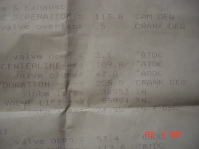

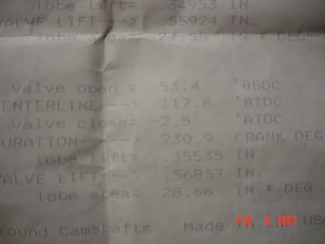

Got some valve event specs or anything else? Post up what you've got on the cam card. Who ground it?

NuTek custom grind.

What gears do you have?
A 114 LSA is usually for emissions or boost but I didn't think that was a concern in Detroit.
For a non-emissions NA car I wouldn't run one that wide, but if it is in the car and you like the power don't overthink it.
A M6 car should have at least 3.73s if not 4.10s the double overdrive soaks it up and it will help lowend a LOT.

Stock gear. Emissions isn't a concern but I wanted the 114 for the smoothness.
I am going to buy a 4.10 gear in the next week and have it installed while it's in storage.
So once I put in the bigger gear it will probably wake it up a lot and maximize the cam? I ordered a new set of headers which should be here tomorrow so that should free up some of the blockage I'm getting from the crappy Y pipe that's on my car now.
