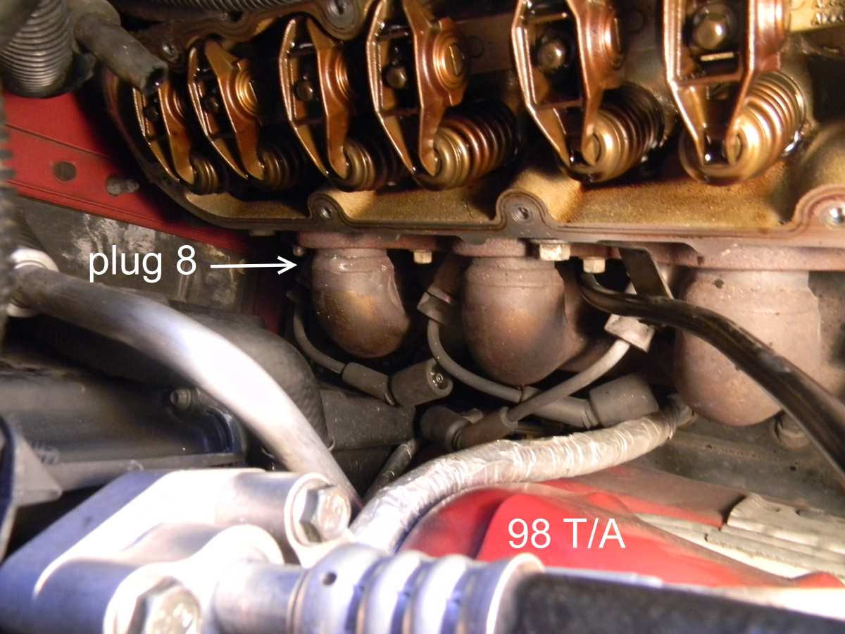

The #8 plug is easier to get to if the passenger side valve cover is off. I could not do it from underneath either. I have stock manifolds, so might be different for you.
