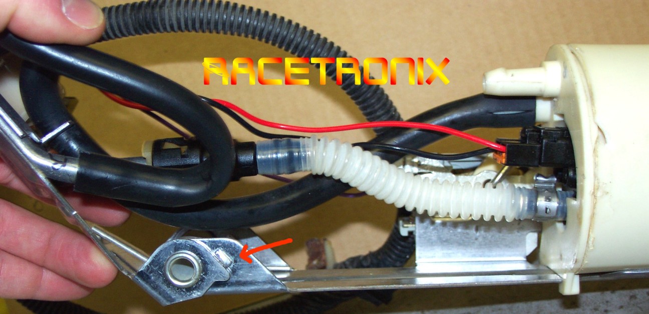

Wait. Lets go back a few. I only bought the pump assembly without the harness. Now can you explain what you said about the "Did you connect the flex tube to the black push-lock fitting or directly to the metal tube?"
Old Dec 18, 2004 | 02:34 PM
Racetronix's Avatar
Joined: Oct 2001
Posts: 784
Re: Help Troubleshoot possible fuel problem
"Push the expanded end of the pump's flex tube onto the black push lock connector (not the metal tube). It may be a bit tight so use some supplied silicon grease if required. Tighten the gear clamp firmly. Do not over tighten the gear clamp causing it to distort."
http://www.racetronix.com/images/FLT1/Dcp_1590a.jpg
Old Dec 18, 2004 | 02:38 PM
96lt1Camaro's Avatar
Joined: Oct 2003
Posts: 164
From: San Diego CA
Ok. I connected the flex tube directly to the metal tube. I did not use the black push lock connector
