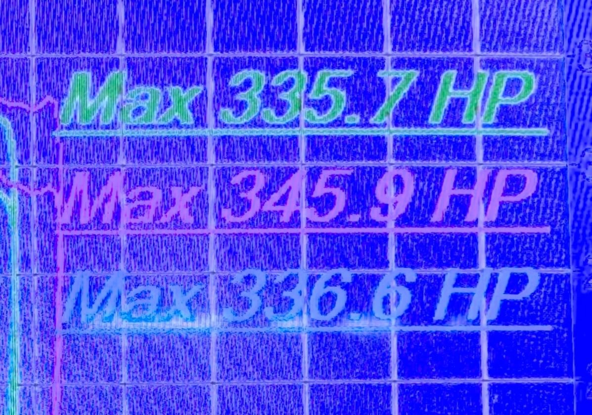

Had the car dyno’d today - couldn’t be happier.
In 2009: Regular 301 hp/328tq, 100 shot nitrous = 404hp/450tq.
Today, 4 pulls (no printouts - monitor screenshots ONLY) 77 degrees, 60% humidity.
1st pull = 349.9hp, no torque displayed. Warm engine, hood closed, fan blowing on front of car.
2nd pull = 336.6hp, 350-ish peak torque, engine heating up, hood closed.
3rd pull = 335.7hp, 350 torque, engine getting hotter, hood closed.
4th pull = 345.9hp, 360 torque (pink graph) engine very warm, hood open.
It really felt like the car is running better than when I last drove it in ‘09 and the dyno numbers seem to support that.
Was scheduled for dyno this upcoming Thursday but rain in forecast (maybe 5 degrees cooler) so, did it today
Different shop, different dyno. Not sure what the margin of error is but, I really feel like replacing the sensors has made a difference - most were original 1994.
