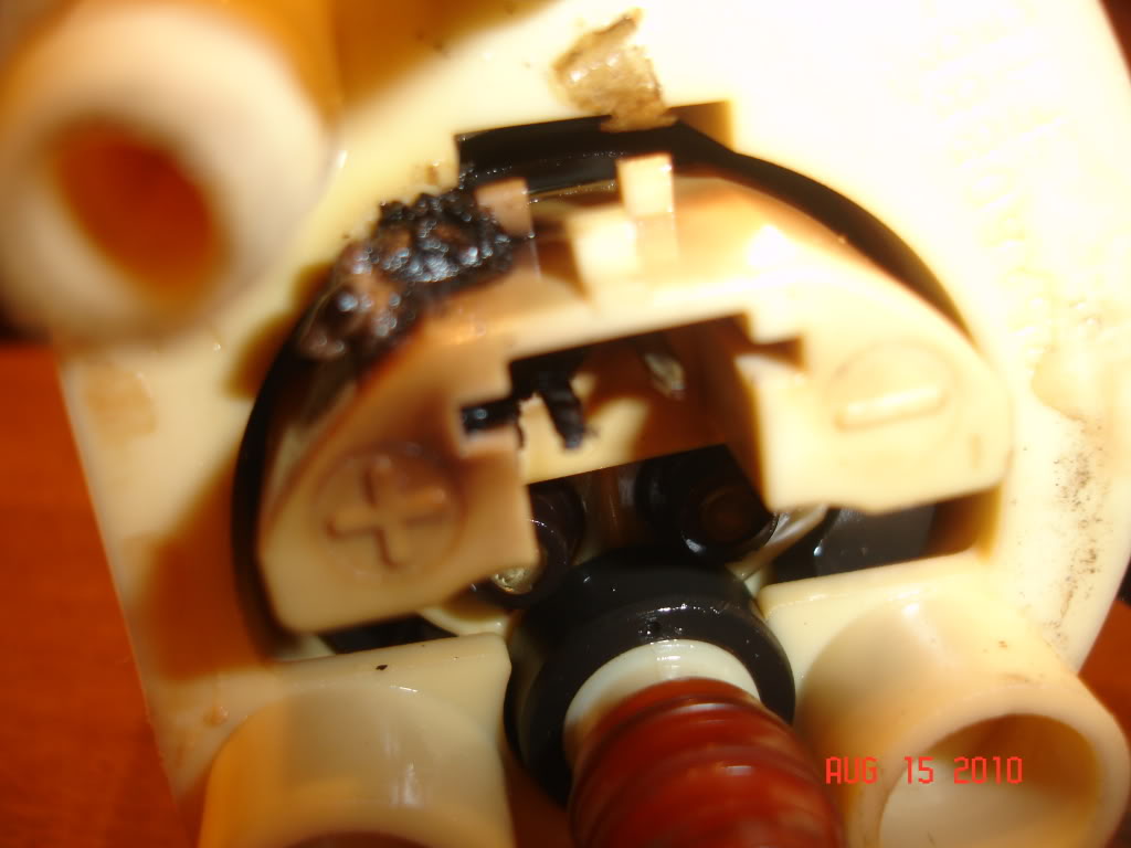

found the short.. hard to believe it didnt blow up.. Maybe good thing I had a full tank.. Time to research fuel pumps.. Thanks for your input..

Be thankful the fuse blew......

Yea I see that.. Glad I didnt opt for the bigger fuse to see what would happen.. The wires to the pump got so hot the insulation melted of the wire and melded them together..Name:  DSC08338.jpg

Putting in a bigger fuse to "see what happens" is always inviting bigger problems.
Glad to see you found the problem and it didn't turn into a bigger mess.
