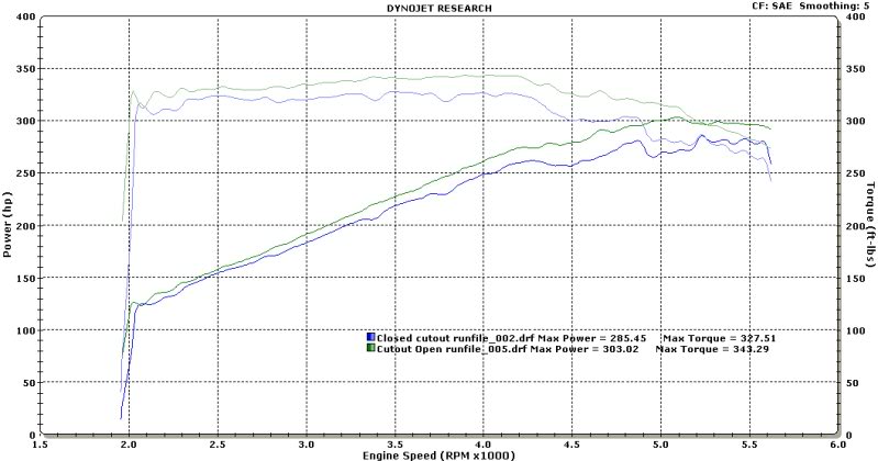

went 13.5 with cutout closed and 13.2 with cutout open
those times are with a untuned hotcam, the dyno graph below is with 1.6rr, shorties, moroso cai, free mods etc etc
