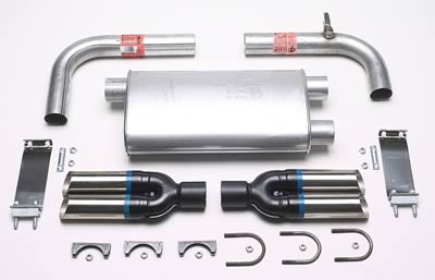

Alright I think I put an exhaust kit together.
Here is the list of parts I have assembled:
Dynomax Ultraflo SS 2 1/2" in, dual 2 1/2" opposite out (like stock)
(2) Hooker 2 1/2" to 3 1/2" slash cut tips, 11" long
Dynomax right and left side 2 1/2" tail pipes
Dynomax 3" stainless band clamp
(2) Dynomax 2 1/2" stainless band clamps
With the $75 rebate Dynomax has going, this comes in at $238.91 shipped from Jegs. The only thing I don't know about is hangers for the muffler. Any help?
I just went out into the parking lot at work and measured the intermediate pipe where it goes into the stock muffler. I got 2 1/2". Fortunately, this allows me to run the 17266 Ultraflo SS like I originally wanted.
Thoughts on hanging method? What in the Dynomax Super Turbo catback kit do I need to buy to hang something myself? Just a few details left!

Anyway, I pulled the trigger and ordered a bunch of stuff from Jegs. Here's what I ordered:
Qty. Item Item Price Subtotal
2 Hooker Large Bore Exhaust Tip Extentions - 2-1/2'' Inlet, 3-1/2'' Outlet, 11'' Long
Item # 520-22208 $19.99 $39.98
1 Catalog Item - Dynomax Exhaust EXH PIPE
Item # 289-42316 $31.99 $31.99
1 Catalog Item - Dynomax Exhaust EXH.PIPE
Item # 289-42318 $31.99 $31.99
3 Catalog Item - Dynomax Exhaust BAND CLAMP-STAINLESS
Item # 289-33226 $11.99 $35.97
1 Catalog Item - Dynomax Exhaust ULTRA-FLO CAMARO/FIREBIRD
Item # 289-17266 $166.99 $166.99
Subtotal $306.92
Handling $9.99
Ground Delivery Charge $ .00
Ohio sales tax $.00
TOTAL $316.91
And I will qualify for a $75 rebate from Dynomax, so the grand total is $241.61. I will let everyone know how it works out, or if I needed extra parts.
