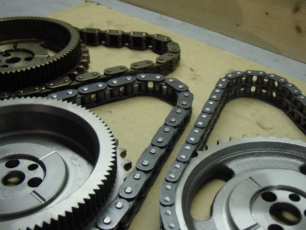

The LT4 timing set is a single roller. You upgrade from stock to the roller for durability, not HP gain, simply because there is none. One could maybe make the argument that a double roller/single roller is HEAVIER than the stock one, actually reducing HP. But in actuality the HP gain/loss here is negligible at best.
Reliability and durability are why people upgrade. If you want HP, convert to a double roller (Cloyes 3145) and an electric water pump. This will net you around 10HP.

Here is a picture I saved awhile back of the three types of chains. Stock on top, LT4 in the middle, and Cloyes double roller on the right.
I'm sold. But yeah, that's why I said "negligible Hp gain" in my beginning post. This helps a lot though. Two quick questions:
