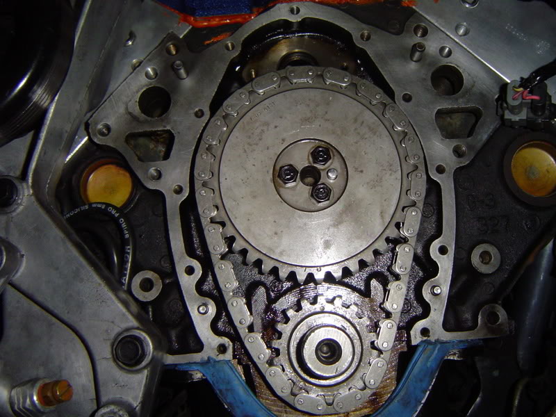

Well it turns out the timing was off a tooth, I re-did the timing
Hopefully its right this time, does this look correct #6 is tdc

Is that a new chain, It looks loose?

ya its new, i didnt torque down the 3 bolts yet

Yeah, looks like you've got it right. But, spin the engine over a time or two by hand, and see if they still align.

update : I rotated the engine 2 full times and the dots line up fine as in the pict. I guess i will see how it works, just waiting til tomorrow for the wp and timing gaskets to get here

well it turns out brand new opti was bad, swaped with another and it fired the 1st shot
