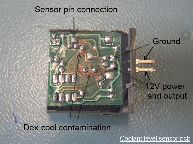

The low coolant light has a “latching relay” in the circuit. That keeps the low coolant light on for an extended period of time so you don’t overlook it. In 96 they incorporated the latching relay in the body control module (BCM). Possibly a problem with the BCM, which is prone to deterioration of the printed circuit boards. Could also be a faulty coolant level switch, which corrodes due to coolant intrusion in the printed circuit board.
Unplug the low coolant sensor. If the light goes out, most likely a sensor problem. If the light doesn’t go out, most likely a BCM problem.

Unplug it and the light should go out. I got tired of replacing it for no reason on my 98TA and unplugged it. The same bad designed sensor is on all Gen 4 Firebirds.

I cut open two of my failed sensors after they failed. Both were contaminated with the coolant (orange Dexcool). Bad sensor design.
