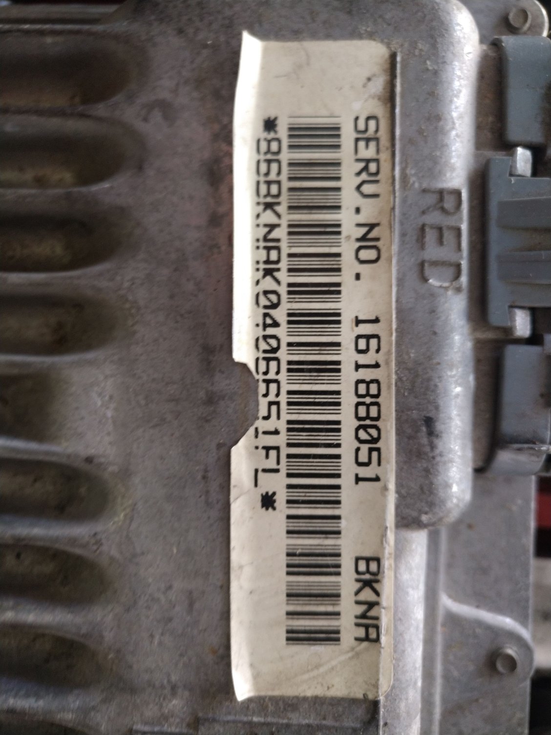

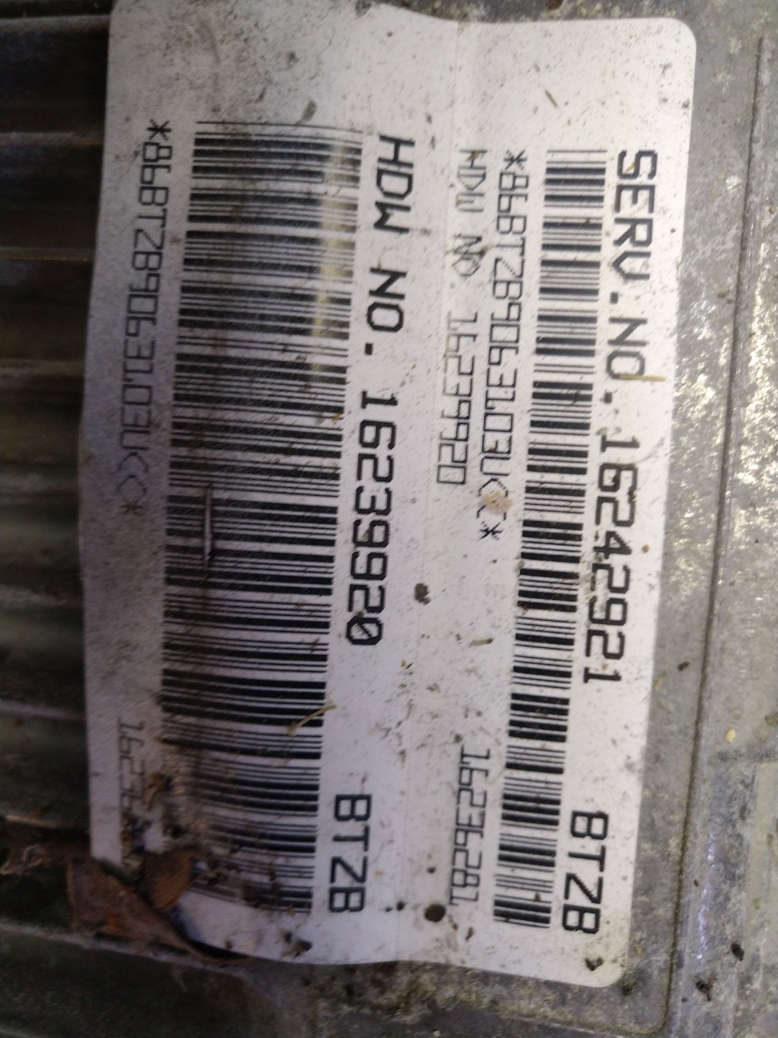

Ok, Lets try this:
My Camaro is a 1997 Z28 with the LT-1 and the 6-speed manual.
The engine had a very loud knock at idle so I bought a rebuilt LT-1. The numbers match engine for engine but it came with a different computer.
Computer that came with rebuilt engine
Computer that came
Rebuilt motor
original motor
with the 1997 Camaro

PCM Service # s
94=16188051 OBDI
95=16188051 OBDI
96=16214399 OBDII
97=16242921 OBDII

Thanks for the reply,
I take it I have a motor that was set up with a OBD1 and I want to use it in a car that was set up with OBD2. Can this be done?
