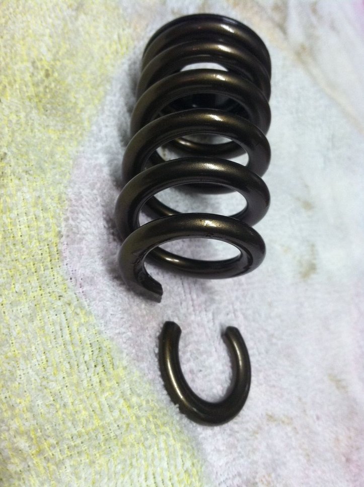

918 spring height spec is 1.800" installed height. If your cam is stock or not a much higher lift than stock you "likely" are OK installing them tighter at 1.75" but that will increase its open & seat pressure and bring it closer to coil bind if you run a high lift cam
beyond that 918's have a horrible record of breaking. If you can, IMHO, return them and get the plug & play Lunati LT1 kit.
If you are intent on running the 918's than check them every 5-10k mi and consider replacing them after 20k mi
If you have a stock cam and install them at 1.800" they can be OK
this was after 18k mi
