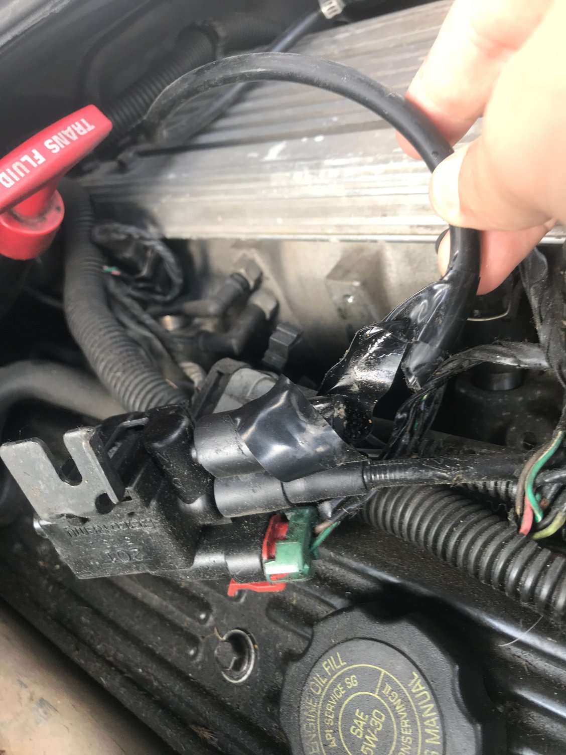

I haven’t ran the codes yet. I’ll have to do it soon but I think I found a problem. Considering there’s black tape connecting a fuel line that is laying in the engine. What’s should I do about this and could this cause the problem?

That looks like the EVAP purge line that connects to the black EVAP purge solenoid. The bracket the solenoid connects to appears to have broken or fallen off. It should be screwed onto the side of the intake manifold, see the screw hole in the manifold right behind the tape.
While that line runs from the back of the car near the fuel tank, and is bundled with the fuel supply and return lines, it is used to pull fuel vapor out of the carbon canister in the driver side rear fender, near the gas tank fill pipe. It does not carry fuel. Engine vacuum pulls air in through the carbon canister, and it pulls out the fuel vapor that has been adsorbed by the carbon bed.
If either line taped to the EVAP solenoid is leaking, it creates a vacuum leak. But it shouldn’t cause the engine to die.
Here's what it is supposed to look like, at least on the 94-97 LT1’s. The 93 may be slightly different. In 94 the purge line runs around the front of the manifold, under the throttle body. 93 may be routed from the back.... or maybe someone hacked it up and ran the line from the back of the engine

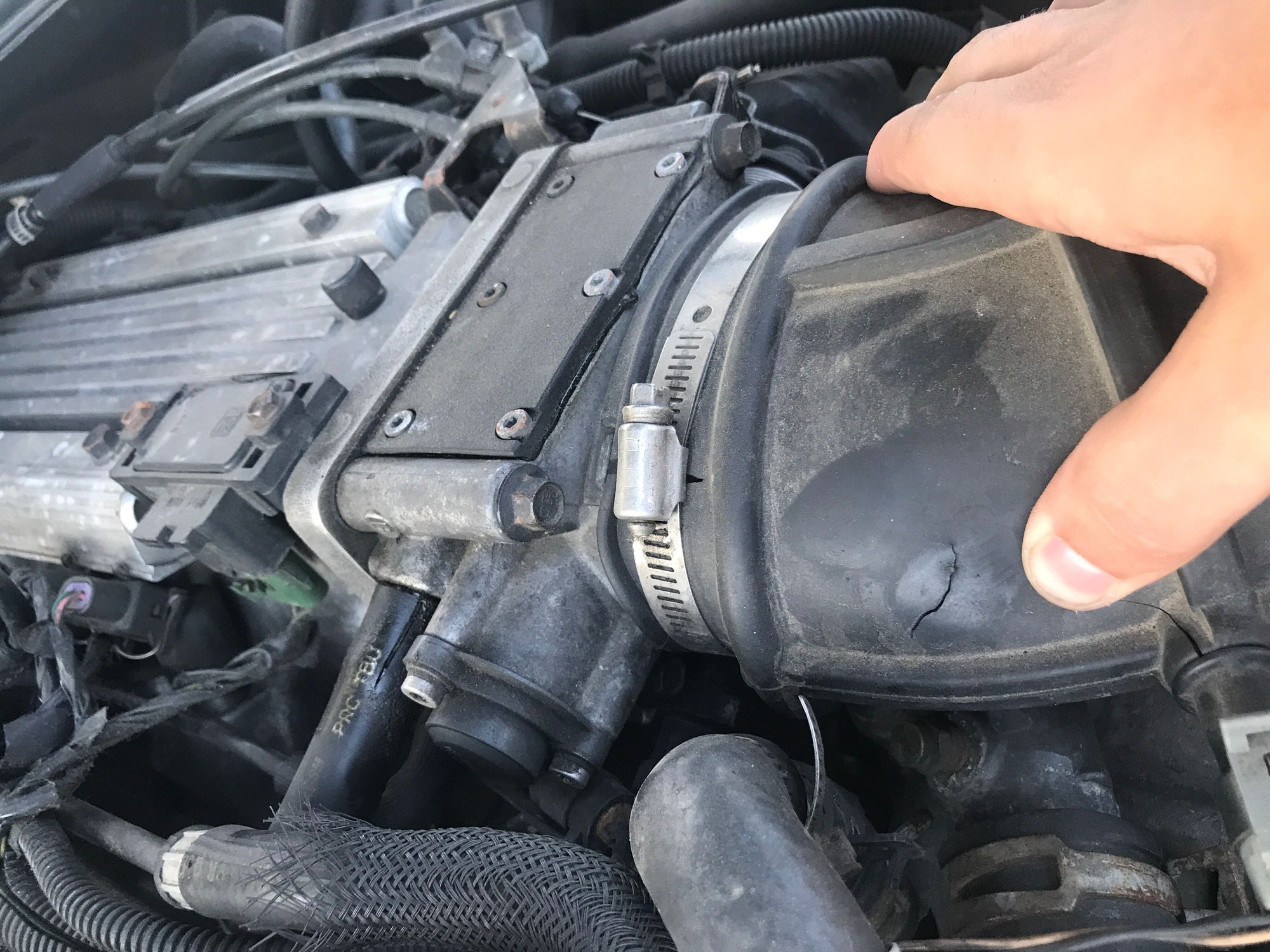

I rented a fuel pressure tester and it got 39 psi from priming it. I turned the car on and it stayed around the same when I revved it the fuel pressure would go up then go back down. I also just realized I have some cracks in the intake. They’re right by the throttle body. Idk if that could be enough to cause a vacuum leak to kill the car or not though. Also today I noticed a loud sucking noise with the car at idle as if it had a vacuum leak.

The only harm is that dirty, unfiltered air is entering the engine. If it had an MAF sensor like the 94-97 LT1’s it would be a problem with air bypassing the MAF. But your 93, with no MAF sensor, runs speed-density, which calculates mass air flow based on RPM, manifold absolute pressure (MAP), and (absolute) inlet air temperature (IAT).
The torn inlet elbow needs to be replaced, but it isn’t causing the engine to die.
