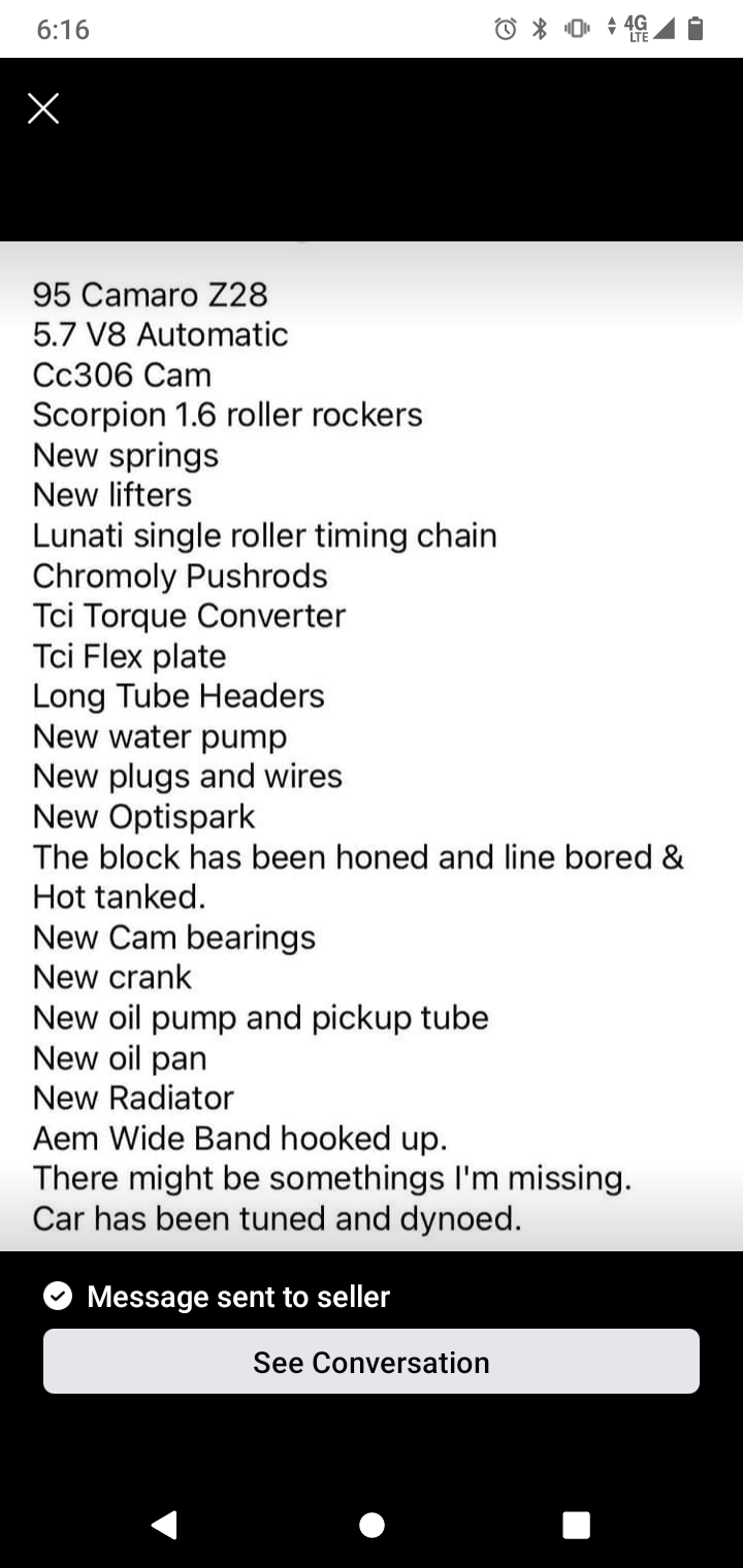

What's up everyone looking for some further knowledge on my car. I bought it like this it has a 306 comp cam bored .30 over whole engine rebuilt K&N intake long tube headers. Just recently I seen my AEM air fuel ratio gauge at idle go as high as 25.2 and when I'm driving it's now around 15 to 19 depending on how much throttle I got on it and the week before it was idleing at 19-20. Car does have a tune on it. I personally have not done anything to the engine so I'm looking for someone with some insight from a similar situation. Car still runs fine just smells kinda rich. Car is a 95 z28
​​​​​​parts list from previous owner
