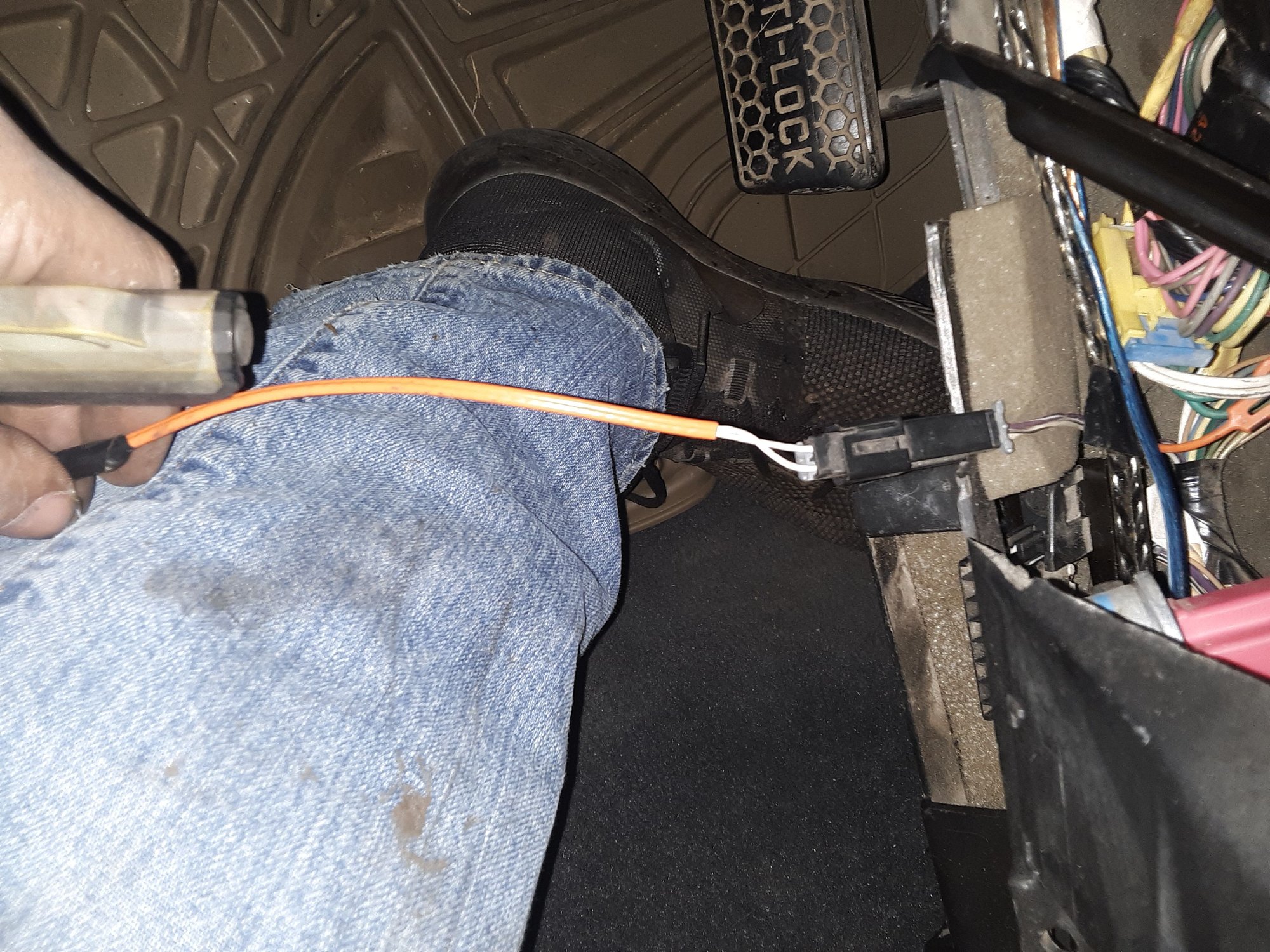

93 z28 tach dont work, when accelerating it drops to zero. Have wires unpluged under
What does this go to?
Old Sep 24, 2019 | 01:49 PM
Daron Neal's Avatar
Joined: Sep 2019
Posts: 21
From: Helenwood TN
Re: 93 z28 tach dont work, when accelerating it drops to zero. Have wires unpluged un
One wire coming in is purple and white and the other is white with black.

Does the tach work when not accelerating - at idle?
1993 LT1 tach is different than all other years of the LT1. It is driven off the coil, where all other years get their signal from the PCM.
Here's the 93 wiring diagram (courtesy of Shoebox), showing the tach filter (also unique to 93), connected to the coil, and having a white wire that goes to the instrument panel.
http://shbox.com/1/93_ign_system_schematic.jpg
The purple/white and white/black wires are most likely the VATS (PASS-Key) wires from the ignition lock cylinder to the VATS Module. Someone may have done the resistor bypass.
Again, from Shoebox
http://shbox.com/1/vats_bypass.jpg
