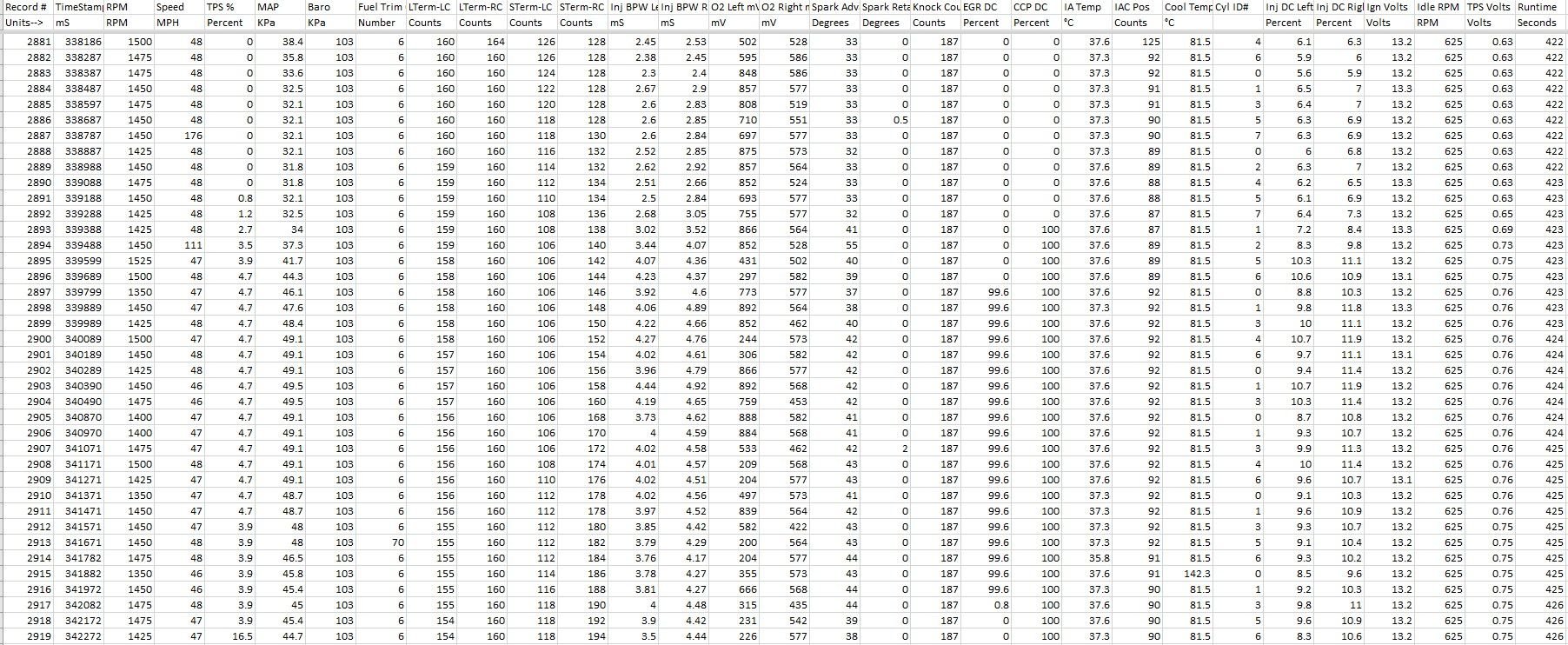

CSV of DataMaster Log
https://www.dropbox.com/s/wc7mfllmba...oShop.csv?dl=0
DataMaster UNI file (Playback in DA)
https://www.dropbox.com/s/vodb2ecvw5...oShop.uni?dl=0

Working on the log. Some spurious interference on the data wire producing impossible numbers scattered throughout the log. Might account for the flashing red light. Makes it hard to review the data... example 5,900 RPM, 255Ms injector pulse width, 292-deg coolant, 255 IAC counts, etc. I like to look for max, min and average numbers, but the data errors make that impossible.
There's some much better (free) software available for producing this info. Scan9495 (works on 93 also) was written specifically for the OBD-1 LT1 by a member named GaryDoug. Has a more useful data. Runs on later versions of windows, pulls codes, clears codes, SRS and ABS on some models, two-way communication, just need a cable from ALDL. Cables:

Seems to be starving for fuel. Worst long term and short term fuel trims I have ever seen.
You're holding constant throttle position, RPM's are bouncing all over the place, and:
As you noted, long term fuel trims (LTFT) are maxed out at the programmed limit of 160. That means the LTFT's are adding 25% extra fuel.
160 / 126 = 1.25
Then look at the short term fuel trims (STFT) - they are maxing out at 254 or 255. That's the largest possible number for an 8-bit field. NEVER saw them go that high.
255 / 128 = 1.99
The LTFT and STFT are multipliers.
1.25 x 1.99 = 2.49
The fuel trims together are adding another 150% above the fuel it should take to run the engine. And it's still running poorly.
It's either starving for fuel, or (less likely) faulty (lean) O2 sensor readings are driving the fuel trims higher, and pouring in extra fuel the engine doesn't need.
The spark plug appearance should tell you which it is.

I'll try and run Scan9495|93 on a newer laptop and also tried loading up TunerPro for diag. Hopefully its less erratic on the errors.

I wouldnt be surprised at this point its not spark/ignition related. I always had a hunch its was fuel related as it only started happening after i burn through the old tank of gas. Upon filling up with a new fresh tank about a year ago i started experiencing the stumbe at 2k rpm but it would pass and continue working. I'll try and see if I can pull a plug or two and see what they look like. If the injectors are indeed clogged I'll send them out to service or maybe just swap back to the stock 22# units for a quick test. I think even with the wrong injector constant for the svo 24# it shouldnt run this bad. Might be a easier test then waiting a week to see what the results are on the injector cleaning. Thoughts?
